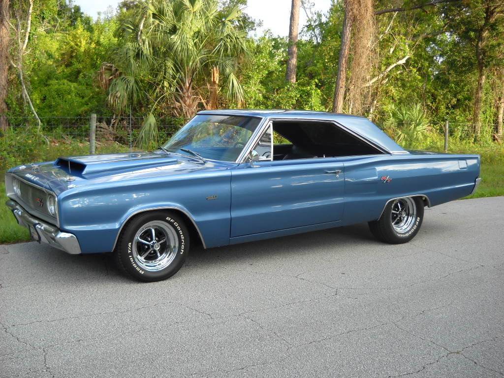

I like old style here's mine

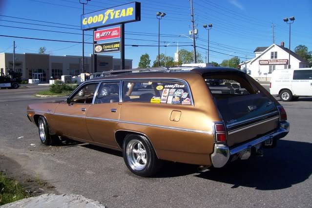

Now I have a woodie

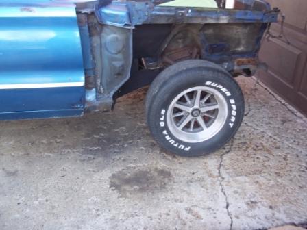

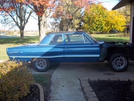

I second the woodie, I can't wait til mine gets to that stage..but it will be a long time coming. Here is a shot from this morning. Its currently sitting on Cordoba wheels but they need some TLC to look decent.
I totally forgot about that style of Cordoba wheel. You dont see them very often, they kinda look like the ols Halibrand spindle mount front runners, if you dont get too close, and kinda squinch-up your eyes.

ilm65,That is a sweet looking ride!! kb67 the mag 500s look good but you have to choose after all it is your car! Myself I don't like the look of 16-18" wheels on the older cars!JMO
What are you doing with the 'Doba wheels when you're done with them?
I like the look of this one... http://wildmusclecars.com/coronet-super-bee/low-key-coronet/
I will probably sell them to recoup any cost I can from whatever I buy. If somebody is interested in them, throw me a set of steelies and a bit of money toward the purchase and I'd give em up. But they really aren't too bad and being 15" clear my front disks.
I am not sure what size I will eventually run, I may need something larger after I figure out my rear brakes. I plan to retrofit Jeep Grand Cherokee rear disks.
I am not extremely worried about the 100% stock look though I have seen several I like both ways which makes the decision difficult.

What;s the wheel and tire combo on your set up?
The fronts are 225x60x15- 7" rim, backs are 275x60x15- 8" rim 41/2" back space, but I had to shorten rear 9/16" outside the spring perch on both sides to get them to fit with out rubbing, worth the extra work.
i know this is a blast from the past but i keep coming back to this thread and drooling over this 67

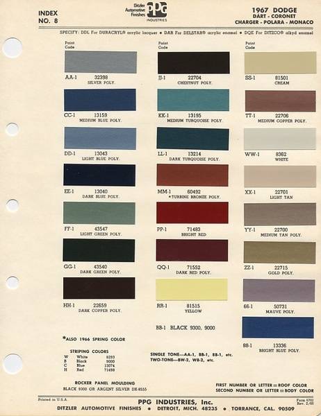

what color would this be? I'm assuming Light blue poly (not medium) ?
