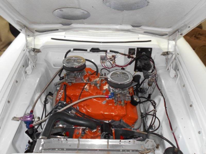

I can't WAIT to see how that works out!I completed the swap of the factory style cross ram to an Indy 440-25 (keeping the same dual eddy 750's on top)
My old 498 with box stock -1's, 270/.650 cam, made 650@5750 with a stage 1 63 crossram. It made 710@6750 the same day, same carbs with a 440-25. Never even made a jet change. So there was probably more in it. Started the pull at 4000. It was better from 4000-6750 everywhere, lost nothing at any rpm level.The story goes: Indy 440-25 is 90 - 100 HP increase over factory crossram. We'll see........
