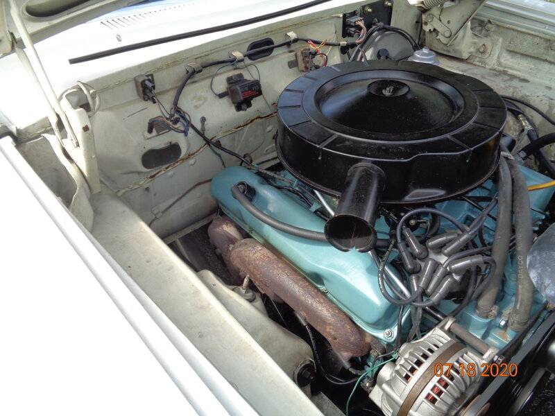

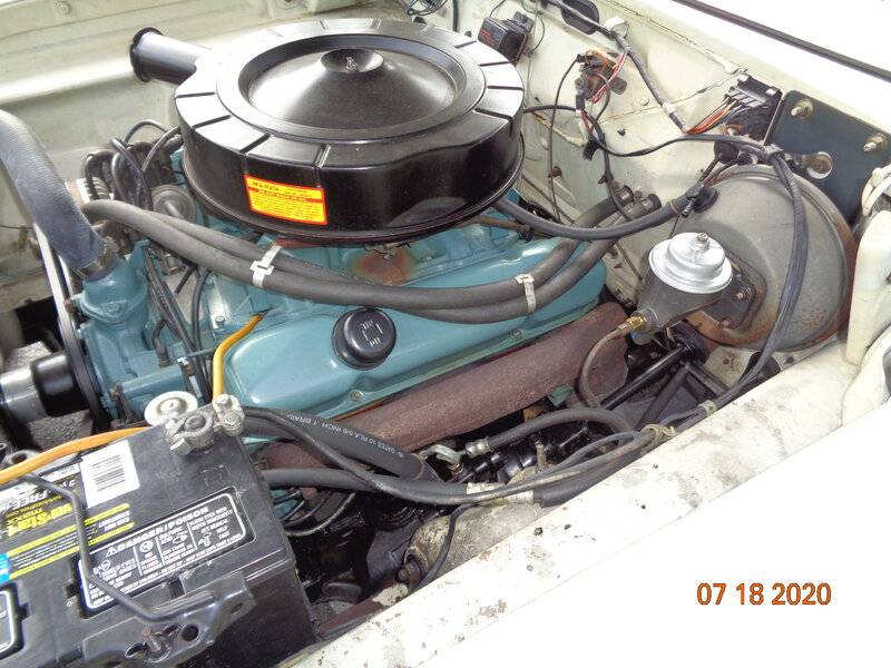

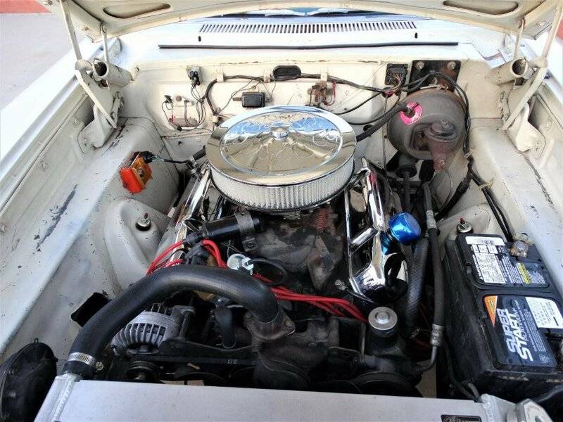

If I was going to do a minor upgrade to my 265 HP 64 361 engine what would you suggest I add? Intake, carb, cam, already has electronic ignition and dual exhaust. Not racing it but would like to get about equal to a HP 383, suggestions?

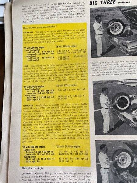

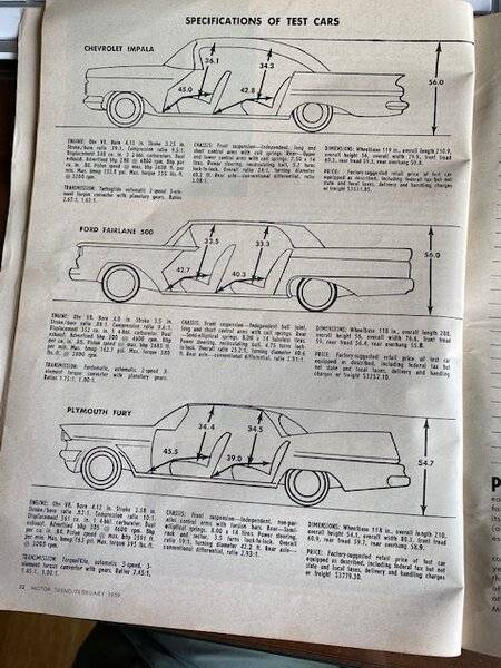

Oh, if you are interested in the Car Specs and Performance stuff, here is that info. Vintage Cars, gotta love them.

The 64 361 was/is 9.0 compression and was the lowest horsepower 361 at 265 with the two barrel intake and carb. Dual exhaust was installed with Flow Masters and the gear ratio was increased to 3.55 open rear end. A factory or aluminum 383 intake with a small 4 barrel would look fine, the interesting part is that the PO sent me the original air cleaner which has dual round snorkels instead of the normal single snorkel. I have found a set of factory 361 valve covers and there is also an electronic ignition system with the orange box installed.

Couldn’t have been the original air cleaner then. That was a single round snorkel affair.

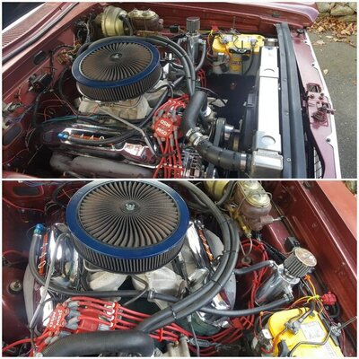

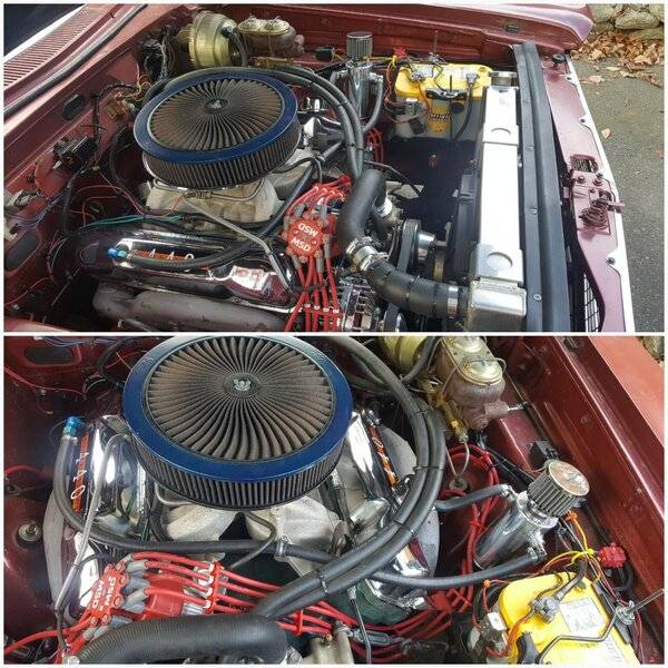

I just turned 74 yo ( had a mild stroke a few years ago ) so at 70yo, you're just a kid. What I can't do myself, anymore, I farm out with the understanding that I know what's going into it. (440 backed by a 727 ) I've added an MSD ' plug and play ' billet distributor, a Quick Fuel"Brawler" 750 carb, electric fan behind a BeCool radiator... and had a local shop with a lot of experience redo the rear suspension with 440-Hemi springs ( 6-drv, 7pass) new front spring mounts, etc. and Cal Tracs. It also has 3" exhaust front-to-back, with Granatelli electric cutouts. Regardless how many Challengers, Mustangs, Camaros at a cruise night, still wakes everyone up ! Keep playing...

I'm just going to go with the intake and carb for starters, not interested in a race engine, just want to add a few ponies to what I have and to keep it as original as possible. I don't need to impress anyone no matter what they drive.
The intake on the car now is the cast iron 2 barrel intake with a 500 CFM Holley. I have purchased a used Performer intake and feel that a 4 barrel 600 CFM Holley would be a better choice than the Edelbrock. The 2 barrel 500 CFM Holley is pretty near the same width as the 600 or 625CFM Holley 4 barrel. I'm not sure what the difference will be as far as performance when you consider going from the cast iron intake and a two barrel to an aluminum intake with a 4 barrel. I realize there are better intakes but when you consider the change between the stock set up and the improved set up that difference alone should be huge.
