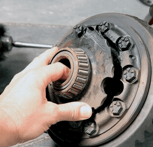

Remember that earlier comment of mine about Ford 9" not being all that tough? Well here is one of the common failures...
Another...
The one I was hoping to find but didn't is the failure of the pinion support... There's a reason Ford made the "Daytona" pinion support.... And Nodular cases, and bigger axles, and improved housings...
