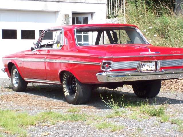

These are Hoosier 29.5 x 11.5 on my 63 Ply. The actual tread is about 10.5 as they say the 11.5 is the width. Ron
These are the Hoosier 30 x 9 slicks. Sorry I dont really have any good close up pics of the rear wheelwells. But my wheelwells are stock and the springs are in the stock location. Ron

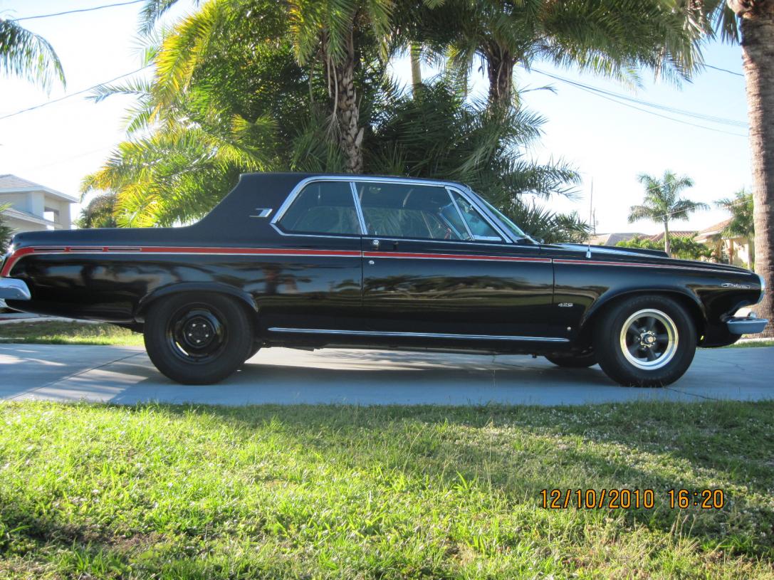

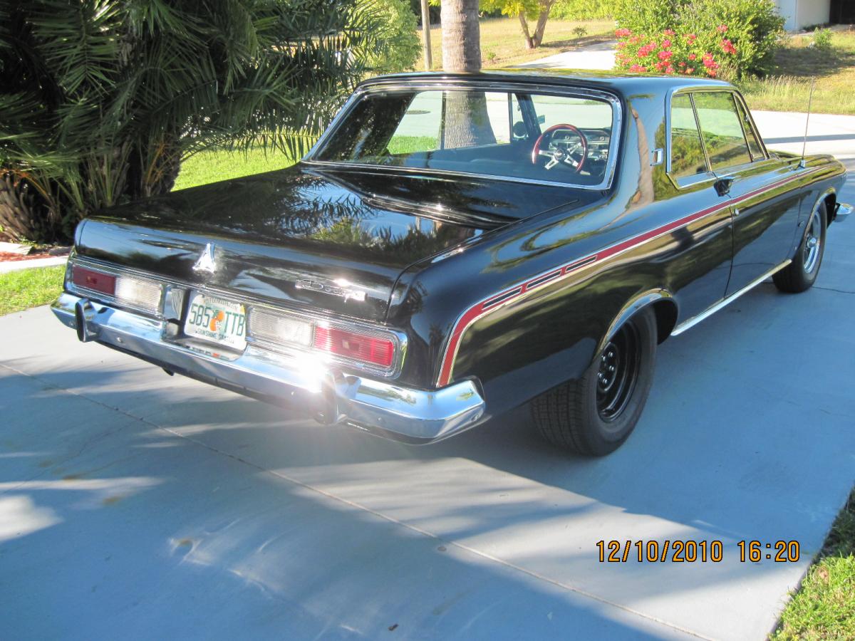

I have 225 75R 15 in front and 295 60R 15 in back (with at least 1" on each side to spare, stock wheel wells/ suspension)

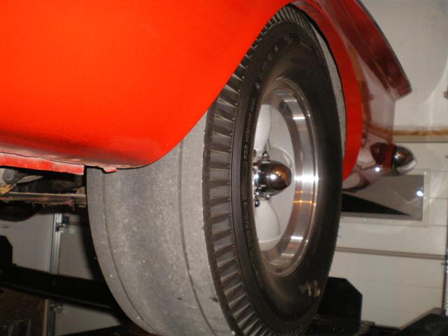

I run Radir 10.5 wide piecrusts with 1/2 inch clearance on each side.
