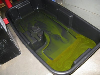

The fluid has a small amount of contamination. There is a greenish slick on top in the drain pan. I just installed a re-cored radiator. Could that be the problem?
If the fluid has coolant/water init do not reuse. Other than that I've reused fluid after repair many times. The reusable gasket needs no sealer but they do not always seem to seal well with the old style 727 pan, for those I use the stock cork with a nut driver used to tighten the pan. They work perfect with the new style 518 style pan, I use a 1/4" ratchet just snug is all they need. Just go around 3 times until they all feel the same.

I had Dexron III in the tranny but changed to ATF +4 when I changed the gasket and filter. I didn't drain the torque converter since they are safe to mix. I saw the new gasket was leaking and drained the pan today.

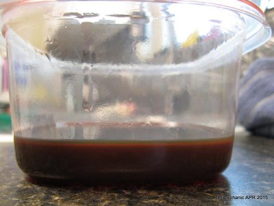

This is what the fluid looks like.
There is no trans fluid in the overflow tank. I had no shifting trouble. Could this be leftover Dex III (non synthetic)mixed with ATF +4 (synthetic) since I did not drain the converter or maybe crap from the new re-cored radiator?
You could take a 5 gallon bucket and hook up a clear line to the return line going into the transmission. Have it go into the bucket If the fluid is green your radiator is leaking into the trans cooler side of radiator

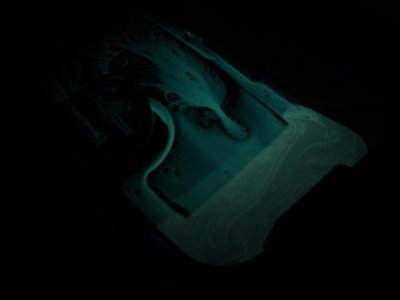

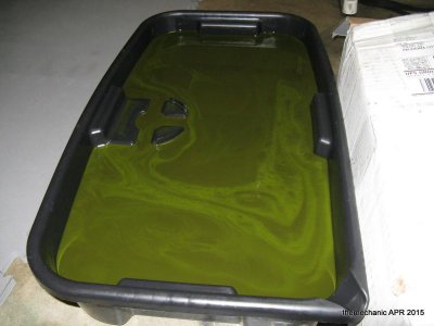

Doh! I just made the Darwin Award's nomination. It was UV dye from a leak detector kit I forgot I put in the trans to find the leak. What a relief. At least I know the dye works. ;)
Here's a photo without and with UV light:
