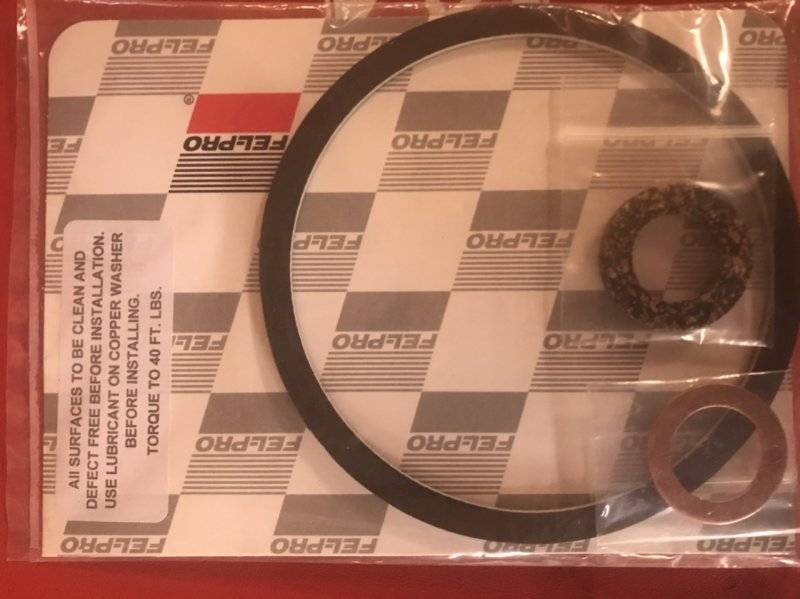

On a 340 with the right angle oil filter adaptor there's a bolt that goes through the adaptor and has a seal on each end; one where the bolt head meets the adaptor and the other on the engine side, and there's a larger ring seal that also goes on the engine side. I bought the seal kit from DMT and tightened the adaptor bolt snug plus about 1/4 turn. It leaked fron the head of the bolt a small 4" puddle while the engine was running until operating temp then I shut it off. After I let the engine cool down the next day I turned the bolt another 1/4 turn. This time it still leaked but just a drop or two.
Anybody know what the torques spec is on this bolt? I don't want to crack the adaptor as it's pot metal or aluminum.

Can't say for sure, but the washers would appear to be similar to oil pan drain or banjo bolt. I'd use a torque similar to an oil pan drain plug torque.
I used the DMT gaskets.
DMT Mopar small block right angle oil filter adapter gasket package for 318, 340 and 360 engines.
Mopar partr# P5249320 For oil filter adapter P5249624AB
Material(s)
.062" Interface gray gasket material.
.062" Copper gasket - between bolt head and adapter
.080" Nylon gasket - between adapter and block
