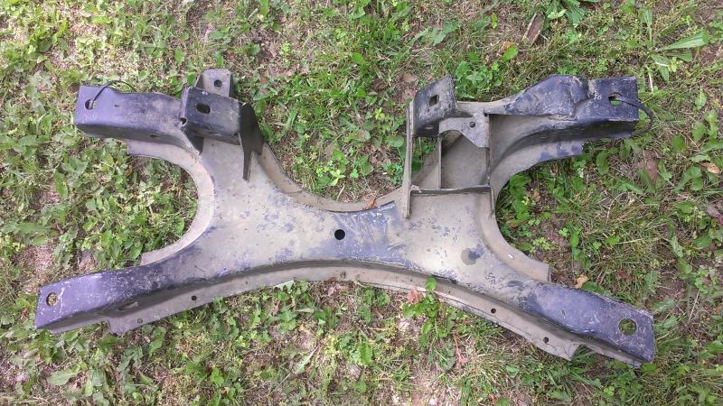

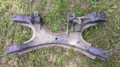

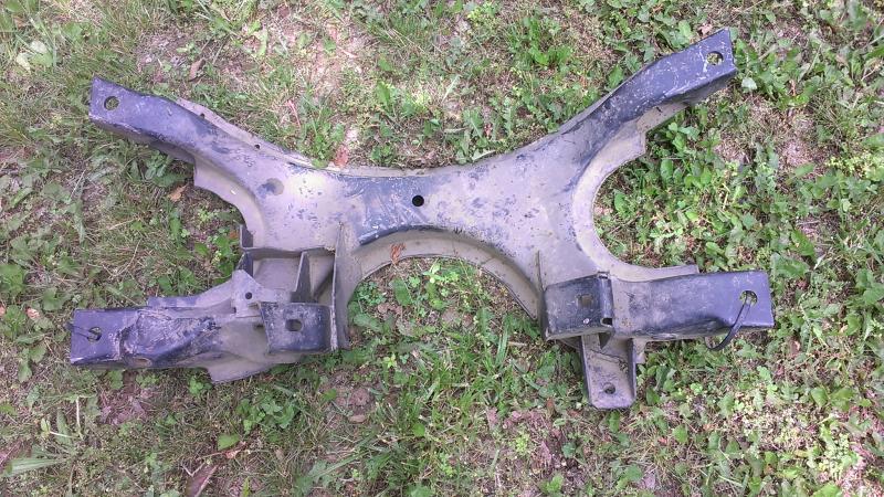

IMAG0418.jpgIMAG0419.jpg Is this the correct K frame for a 1967 383 satellite? Thanks!
Probably is then, I loaded up parts from 3 or 4 B bodies. The scrap man will be happy. Thanks!
That's deffinatly not a slant k frame. I can tell you that but besides that im not sure.
wasnt there a sticky on here somewhere that showed the different year and engine k members?
http://www.forbbodiesonly.com/moparforum/showthread.php?30271-So-you-want-to-swap-a-SB-for-a-BB
heres the sticky,might help, if not google k member identification for mopars or something similiar.
looks like a BB k to me. the motor mounts, the power steering box mount...
Thanks for the additional info!! I have a 67 GTX project and was hoping this would fit, the one in my car is kinda crusty and this one has been blasted at some point. Thanks, again!!
sorry to mislead anyone , the drivers side perch just looked odd. I just used V8 conversion mounts on my slant K member and it looked about the same, but it is also a spool mount...
The 64-65 Ks had two holes in the top of the brackets! That is a 66-67! I have one for sale! It's a 66-67 v8
