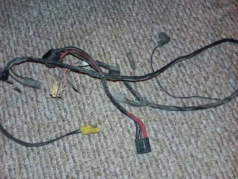

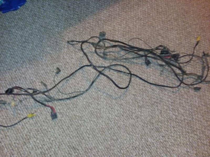

Bought my 74 Satellite last year and came with a bunch of extra parts. Just came across this and wanting to find more info on it and if any way to tell if its any good without hooking whole thing up. Thanks.

LOL! That is the engine compartment harness. You would have to check each wire to verify no breakage.:thumbsup:

Looks like it's not even for your car. Would'nt there be more headlight plugs than that??

Might help if he lays it out in a fashion that makes some sense and then try a quality pic. I've never seen a harness with yellow two cond. plugs like that. Looks like electronic ignition tho.
The yellow ends are for side marker turn signals.

I think im googleyeyed tonight. Maybe all four headlight plugs are there.
I don't think 74 and in fact more from 60s. I can see a black bulkhead conector where these uses to be white on 70s and with longer release tabs, but definitelly they are forward lighting harness and also engine harness since I can see the engine temp wire and plug.
74 should get the rubber socket for sidemarkers, and this gets the L shaped rubber plug with barrel terminals. Neither ECU plug, but it seems the elect regulator is there
I can see a male terminals group without insulator... maybe a missed bulkhead conector there. IT SEEMS to be in fact the end for lighting harness while the bulkhead plug present is maybe the engine one. I can see the plug provision for hood turning lights maybe just at a side of thatbloosen terminals group, allong with the brake warning light for brakes fluid dist block.
My votes are for... Charger 70 harnesses. How many Mopars got hood turning signals, and two wires for sidemarkers on L shaped plug?
