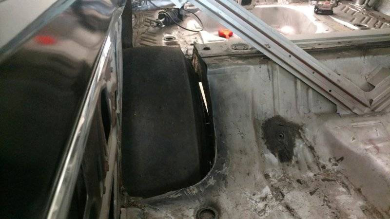

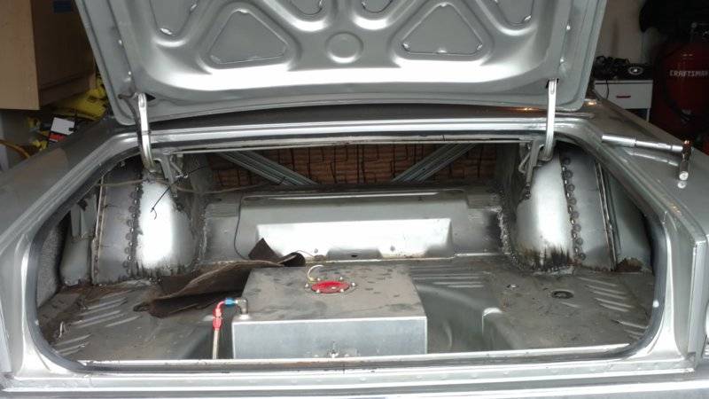

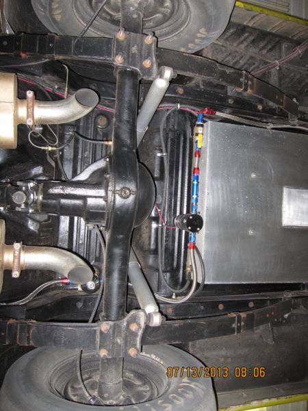

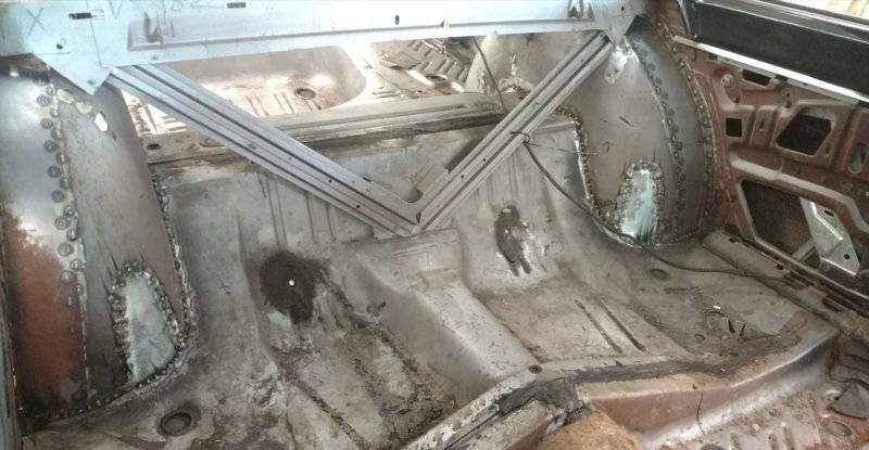

I installed Mancini Racing leaf spring relocation brackets and mini tubbed the wells into the frame. Gives me a full 15" of width.
1967 Coronet.

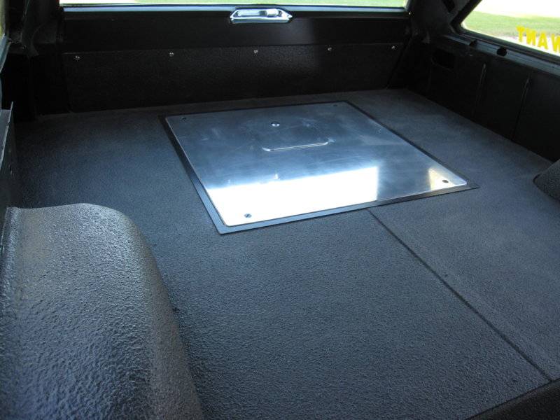

Moved the springs inboard, widened the tubs with a strip of sheet metal (body worked the inside, undercoated the bottom, used bed liner inside) and later went to Cal Trac components on my 66 SW.
Mike

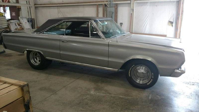

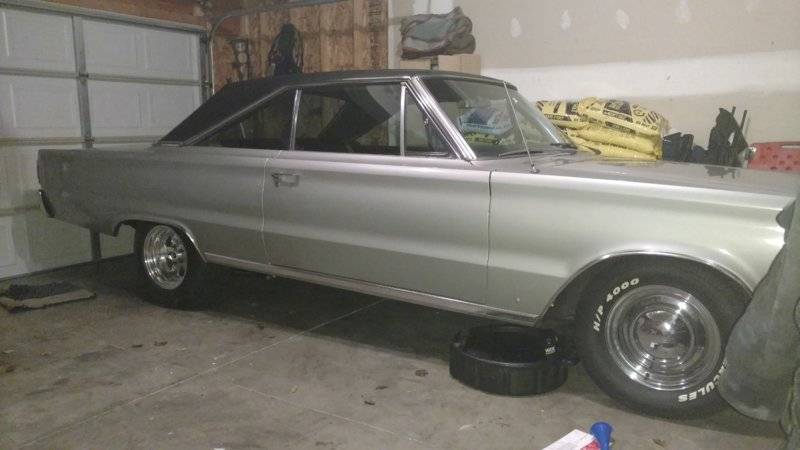

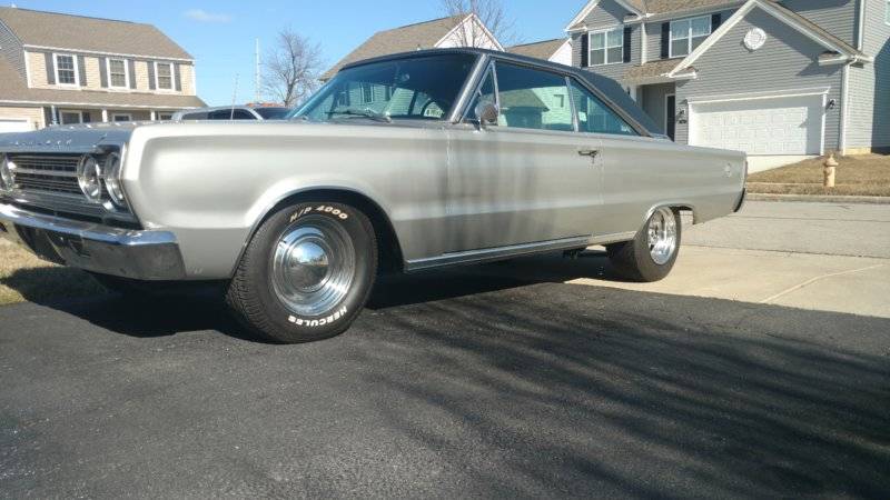

Cal tracs mini tubbed narrowed dana from Moser. 15-12 inch wheel with a 29/10.5w tire which measured 14 across
