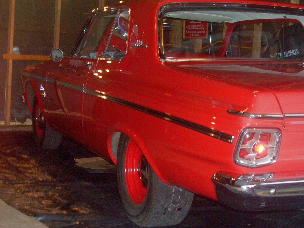

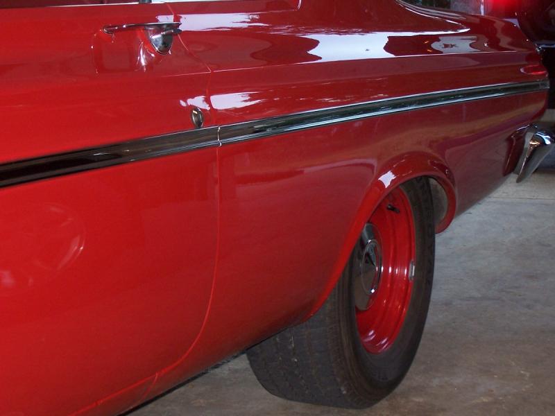

modified my wheels to accept the 14" hubcap?
here are '15's with 14 in hucaps
