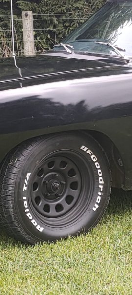

I bought a standard 45mm bearing dust cap for my front wheels and they aren't deep enough (30mm) to fit.
What do you all run that works/fits and can you please provide links.
I didnt think it would be hard to find something.
Needs to be about 40mm + deep.
Thanks

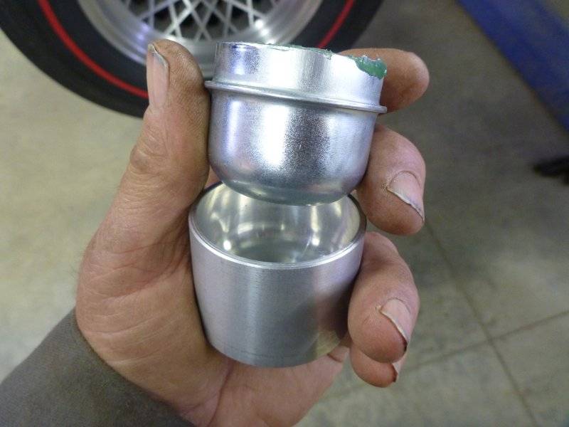

You really need something that will knock them in evenly around the lip. Otherwise they just dent if you try tapping them in.
An oversize socket works....or a short section of exhaust pipe.
I bought mine from Rick Ehrenberg. They fit well.
NOS Mopar Front Wheel Bearing Grease Dust Cap 1972-down A, C, E-Body Cuda Dart + | eBay
I also bought a driver for them from him, but he doesn't have them on his site anymore. It's like this one from Mancini.
MRE - Spindle Dust Cap Driver
