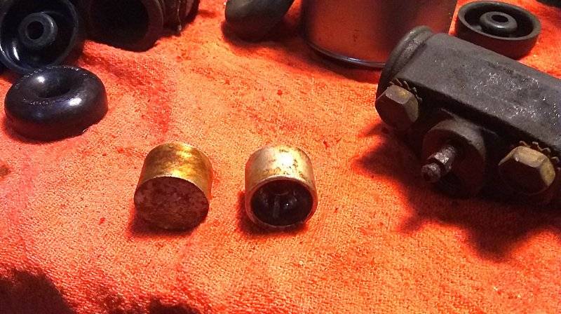

Hello,Since i am going to rebuild some Wheel cylinders i have a question. What is the best way to clean the Aluminum Pistons, They are Not Pitted. Thanks

Brake cleaner works or a soak in your carburetor cleaner bucket. They could also spiff up after cleaning with a trip through the blast cabinet.
