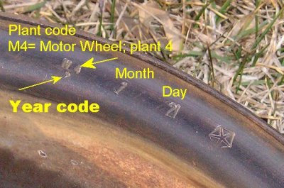

M4 is manufacture code 6 should mean year ie 1976 12 * 21 should be month / day, assuming you mean a space by the 1 digit.

Does this help?

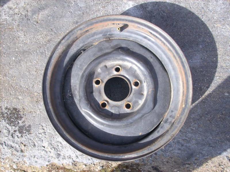

more example
This is what I want you to look for.
Bottom line is these wheels will just rollers for you until you get correct wheels for your hemi car. Nothing else will do than Correct wheels.

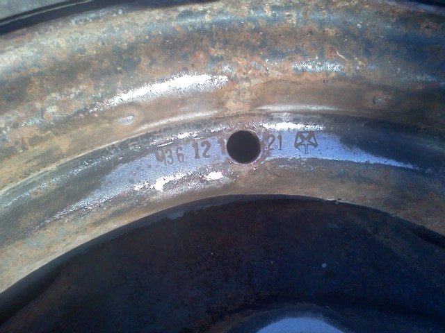

my mistake M36
sorry guys my mistake my bad M36 12 -1 21 see pic my bad

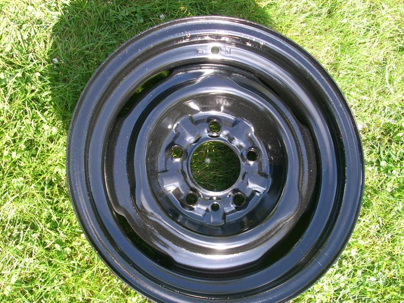

66 charger wheel
Here is a photo of a 66 charger 14 x 5.5 wheel. notice 9" center, deep dish for wheelcover. stamped 5 5 at valve. Not like the 68+ variations.

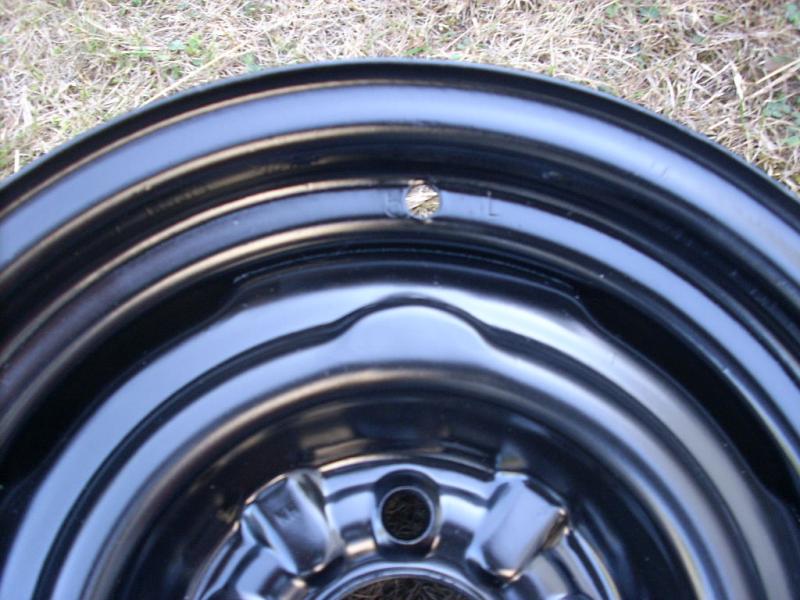

1967 wheels for the high performance cars of GTX or R/T have a rather unique appearance compared to most wheels dated October of 1966 and earlier. They are 14 x 5.5 for all engines, have the 10" button nub size and usually have only ONE guide hole between the lugs. They also have the letter 'L' stamped on the right of the valve hole. See my attached photos. I know of two GTX's that came with wheels with 5 guide holes between lugs, so like anything about wheels, factory and vendor variances occur. Again Chargers came with different wheels, which were deep dish.
