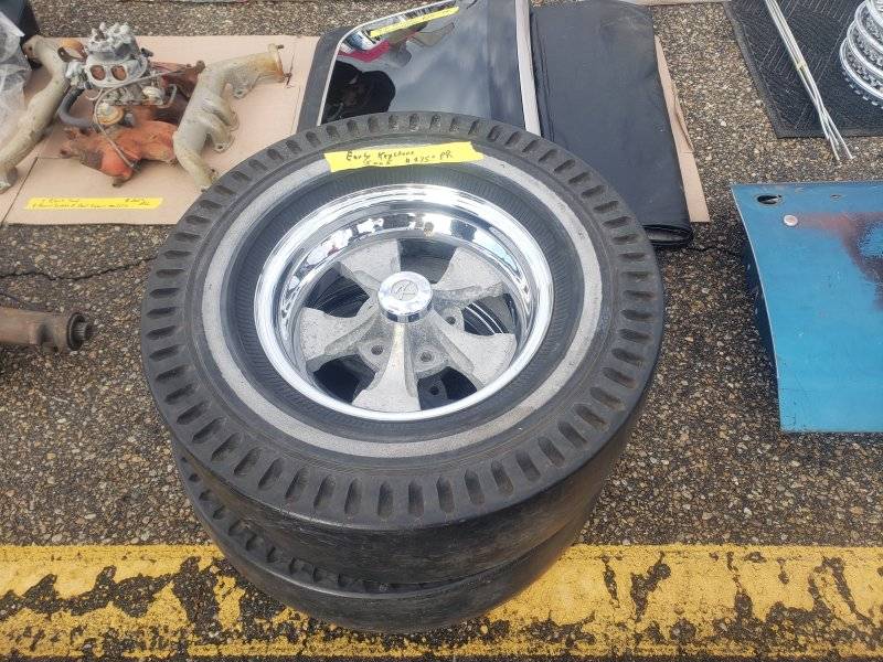

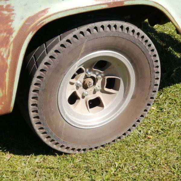

Found some more Dart Board wheels . . .

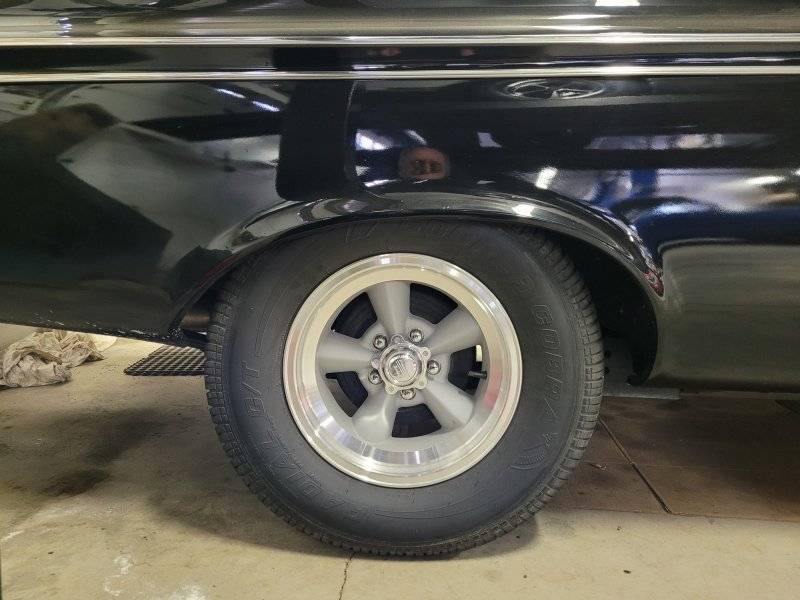

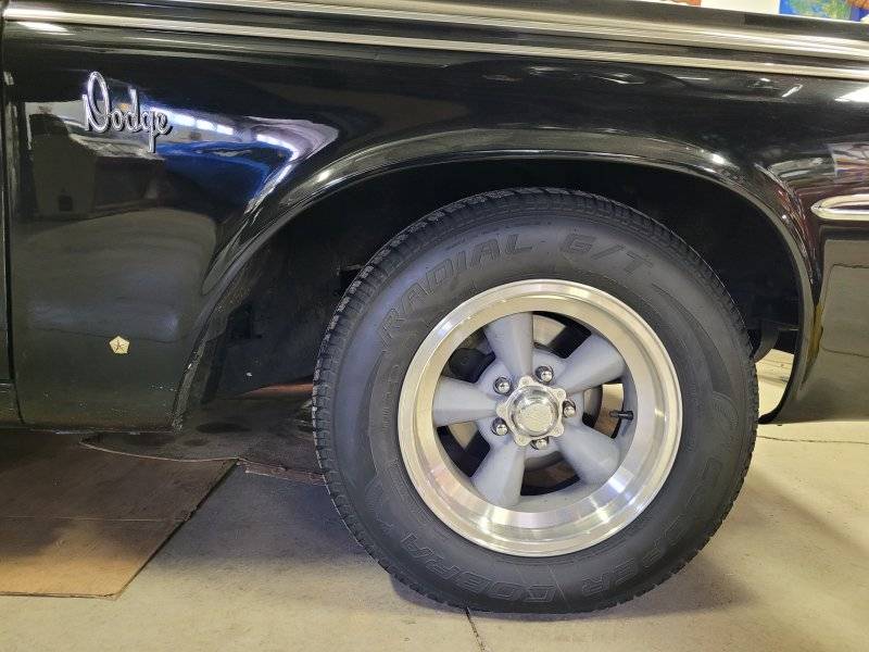

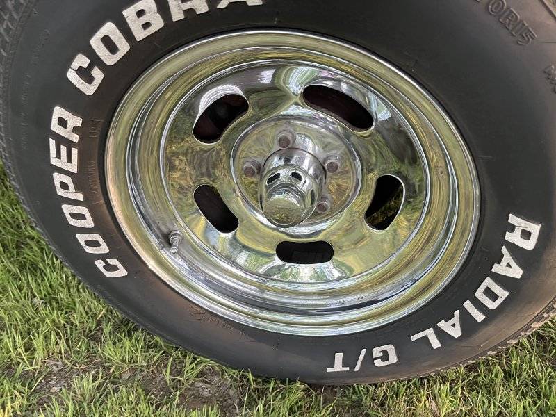

New tires and new to us vintage Ansens. They need polished up.
What do you guys use to protect the raw aluminum finish. I spent a couple hours polishing the rears last fall and when I rinsed them off the hard water left spots instantly.
I used to strip the clearcoat off my FWD Mopar wheels, hit them with Mother's polish, and just keep after them. Gotta dry them after washing, esp. if you have hard water, to keep them from spotting. Meguiars Quik Detail does a pretty good job of de-spotting, in a pinch. You could wax them, but I'd recommend against clear coat because it will eventually lift, and you have to strip them and start over again.

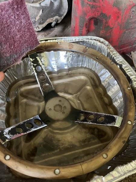

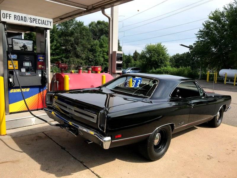

My superior wheel I’m trying to strip paint off to get to the beautiful chrome underneath, then it’ll go on my GTX
