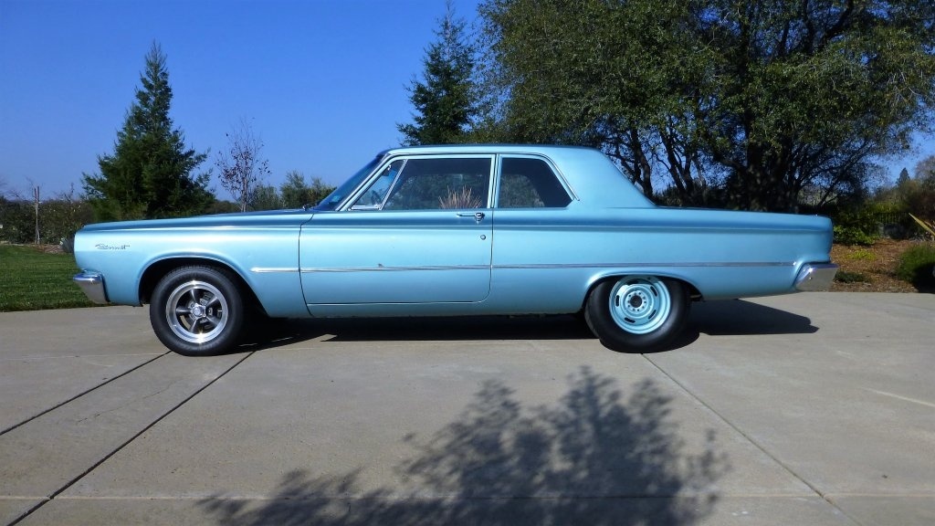

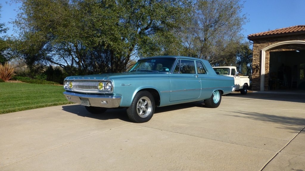

Wheel wells are faily large. The spring gets in the way before the wheel well. My sons 62 Plymouth has 10" wheel with M/T Pro Drag Radials. We did move the front hanger flush with the outer frame rail. Replaced the shackles with sliders. Easy 1/2 day job if you can weld. Less than $75in parts.
