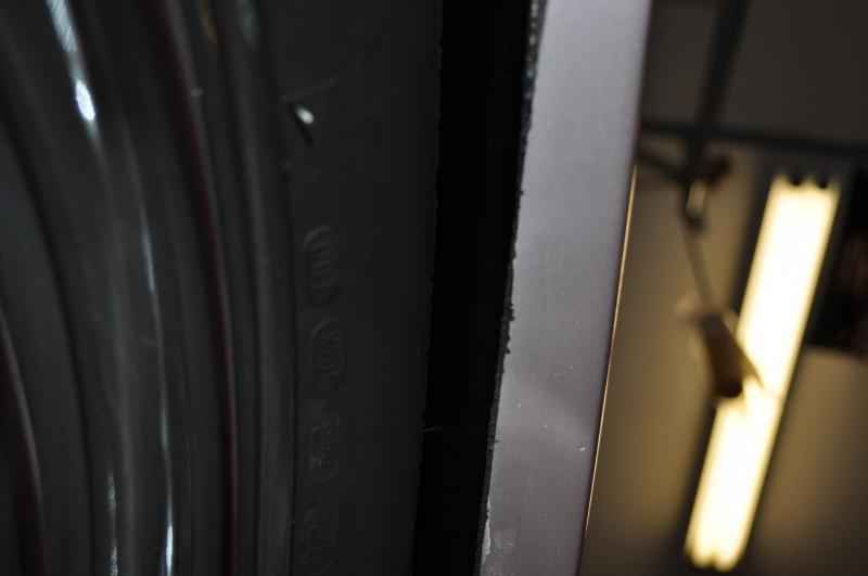

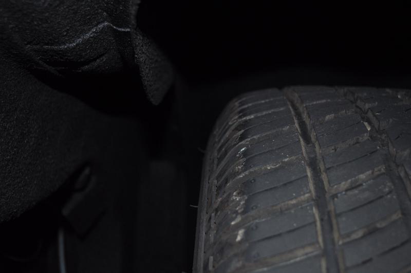

These are photos of my `66 wheel well...with 255/60s on 7" rims 4.125" backspacing.
Outer lip looking up and forward
Inner side looking up and forward.
Hopefully these will help.
