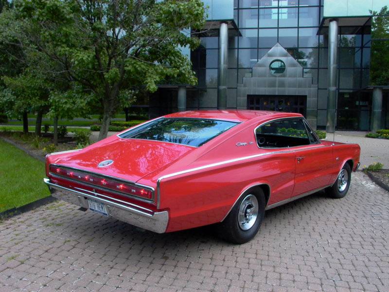

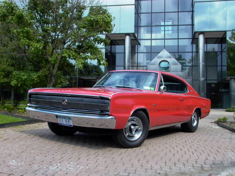

pictures of my 66 charger 15 inch steel wheels
What did you do to get the hubcaps to work? 15" trim rings? I started on that project... maybe time to get back to it.
14 inch ring welded to the wheels. stock 14 inch hubs. Stockton wheel made them for me 18 years ago.
probably will end up selling them at some point. 8" back 4.5 BS and fronts are 6"

Interesting, I was trying to rework the cap to fit the wheel.
528hemi
You mentioned you might sell the wheels at some point. I would be very interested in the wheels if you do sell them
