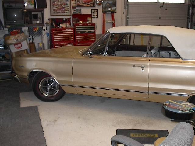

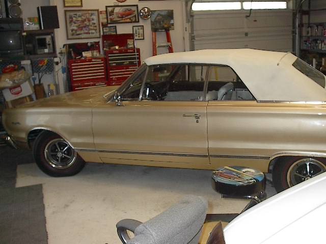

Hi everybody out there in Mopar land, what I am looking for is some help on sizes of wheels
(Crager SS or torque thrust polished or chrome 15 x 7 ) what I have is a 1967 Plymouth satellite convertible 383 auto and I would like to know what any of you folks have put under these cars comfortably without rubs or scraping. I think I prefer to keep all four the same sizes for simplicity. I know that the rear are a real BEAR to get in the rear housing so I don't want to make life too difficult. If you have found a great combination that fits nice and looks great please let me know. Thank you all I am rather new to this thread stuff so I will try to keep up !

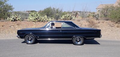

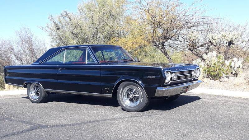

Mine has 15x7 with 245-60-15s all the way around. Nothing rubs at any time. BUT to remove a rear tire I have to jack it up at the frame and let the suspension drop to be able to pull the tire / wheel out from under the quarter panel lip. A bumper jack would do the same thing if I had to

Thank You gtx6970 they look great on your car and thats what i keep looking to find out , i don't mind the lifting at the frame as long as they don't rub . do you have any idea what the backspacing of those wheels are ? they do seem to fill in those wheelwells quite nicely .

I also have 245 60s on the rear of my 67.
4 .25 back spacing on a 7" steel wheel.
Nothing rubs.
Yes for sure there is room for a little more but I can swap a tire on the side of the road if needed.

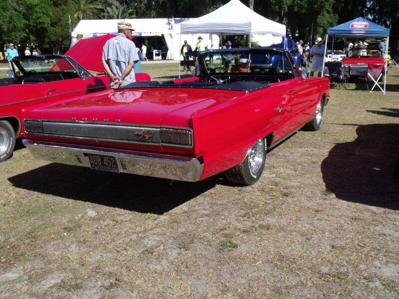

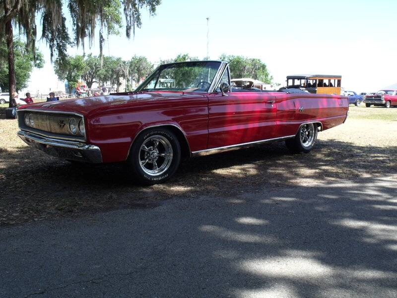

Front 225 60 15 on a 15 X 7 with 4" BS
Rear 245 60 15 on a 15 X 8 with 5 1/4" BS ( I would do 5 1/8 next time)
No rubs .....
