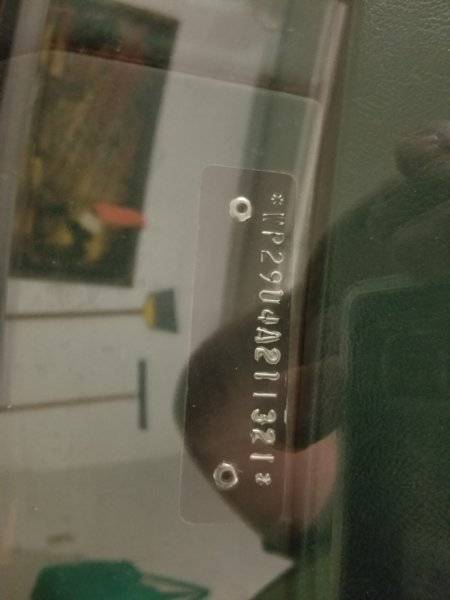

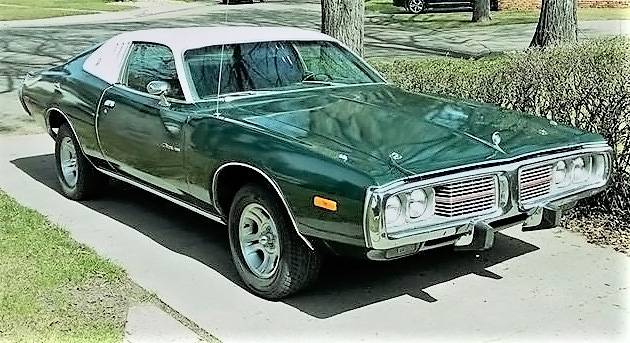

Hello,
I just learned about the U code and had to run out and check the Charger (its a 1974 SE). The VIN number is WP29U4A211321. Is this a U code?
