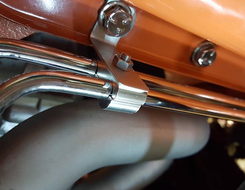

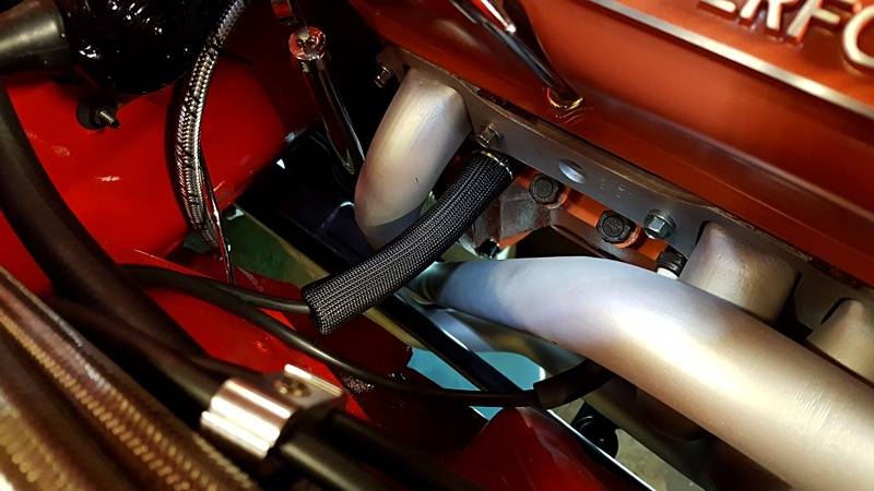

Mine old Hedmans was sandblasted and i paint with VHT flame proof aluminium spray paint. They need after curing in three steps. When i started first time headers glowe red(12 degrees idle advance) Now i run 20 degrees idle advance and after hard running i measure temp. headers is 570F. and paint is perfect(sry my bad english)
