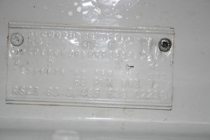

My 67 has .628 on the fender tag, June 28, 1967. Cars built in 66 have a letter and day date on the fender tag from the cars I have seen. I believe it is also on the radiator support with the sequence number. I will check.

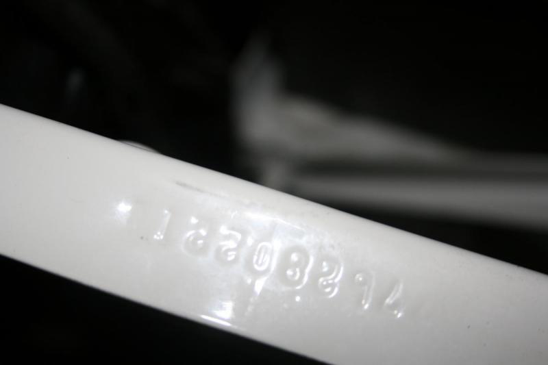

Radiator support is upside down and shows 7 for the year 628 build date and sequence number and fender tag on my one owner GTX. It was delivered to my brother July 31, 1967.

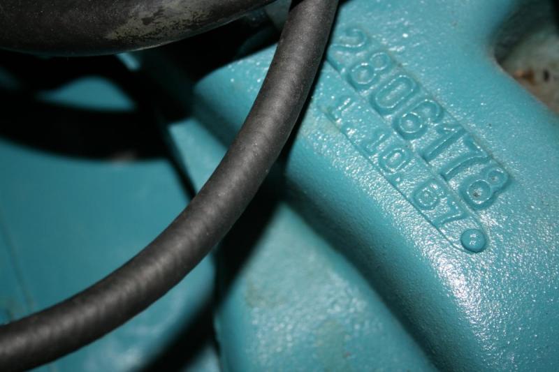

June 15 build date on engine. 1-10-67 casting date on intake.
Check casting date on intake manifold

http://www.mymopar.com/index.php?pid=85
Try this link.
Try this link to decode you fender tag.

My 67 has .628 on the fender tag, June 28, 1967. Cars built in 66 have a letter and day date on the fender tag from the cars I have seen. .
all cars in 66 & newer have letters for production date on fender tag if they were built in Oct, Nov, or Dec (A=Oct, B=Nov, C=Dec)
all 3 of my Chargers have a May date on fender tag, so they read 502, 506, & 521

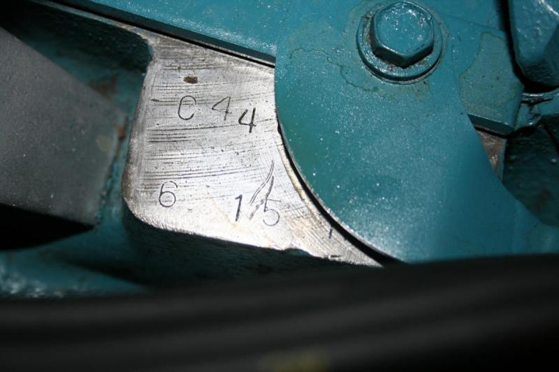

check the pad in front of rail....it should say "C 440"

The 9-19 build date is from 1966. The radiator support also states 919 followed by the numbers on the fender tag.
