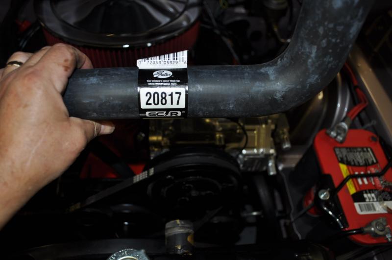

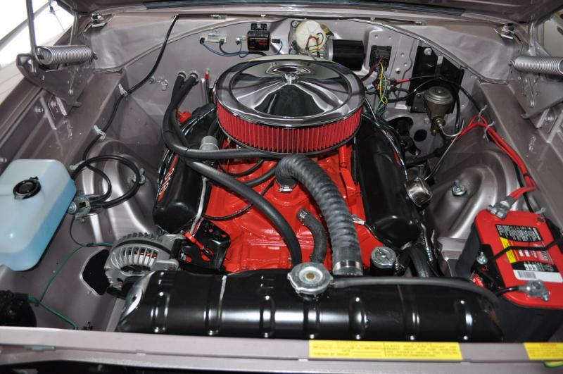

So nobody lists a 'molded' upper radiator hose for my `66 Belvedere Poly 318...at least not one to fit around a dealer installed A/C unit. To get the car on the road, I installed a 'universal' hose.

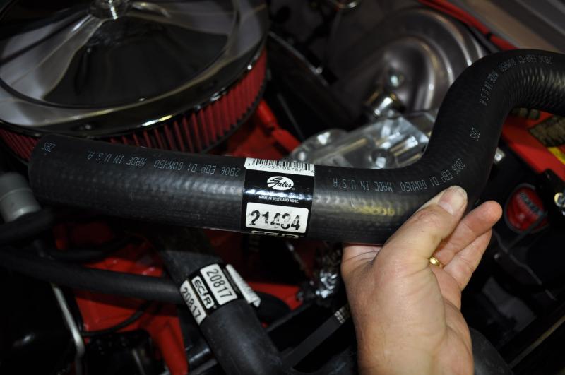

With some time searching the Gates hose listings, I found a couple possible candidates. Ordered 2 likelys from Amazon and crossed my fingers. While each was close, neither would work without kinking somewhere.
But I did notice that each had sections that 'could be used...if I could find a splice.

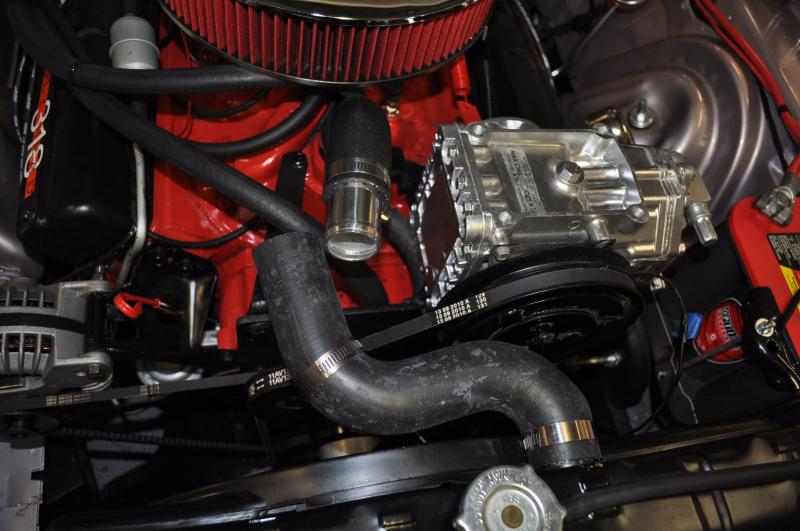

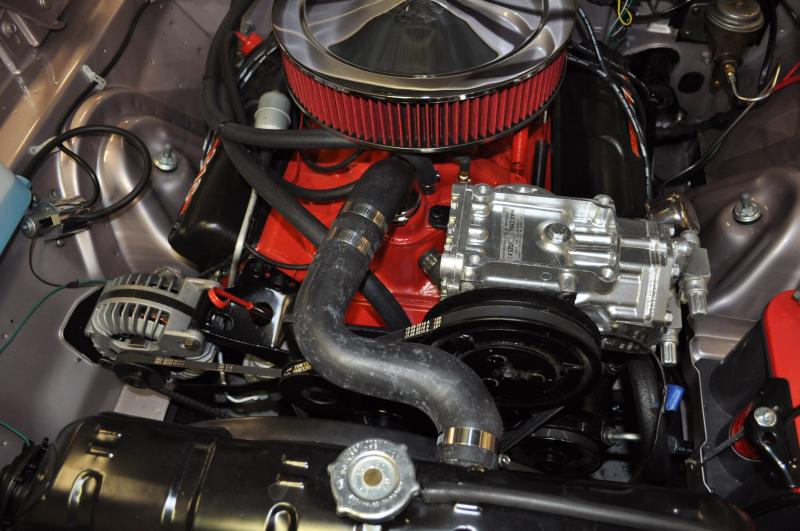

Back to the web, and I found a 1 1/2" x 3" sleeve.
Using sections of the two hoses, I made one.
I think it blends in well. Total cost was about $40

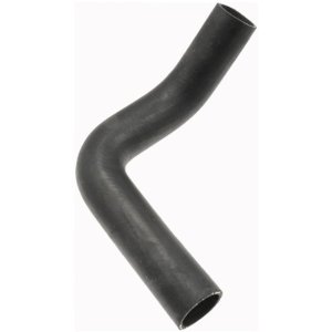

napa show 7164 hose not sure it would be right for yours
Yea, thats for a car w/o (without) A/C.

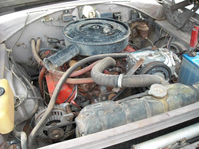

The old hose on this was another universal, only with a 90 degree at the radiator.
A factory style A/C would be a black, center mounted (V-twin style) compressor with a hose going around the driver side of it. Unfortunately these 'dealer'...or 'A/C shop' installed units back in the day didn't quite fit the same. Crazy me wants to keep the nostalgia of it instead of paying more out for a new system. As you can see the Clutch pack creates a clearance problem at the radiator. One of those stainless flex lines was not going to give me such a tight turn. This was my solution to avoid another universal hose using the 'custom' stand-off bracket (flat piece of iron with a clamp) pushing the hose away from the pump.
