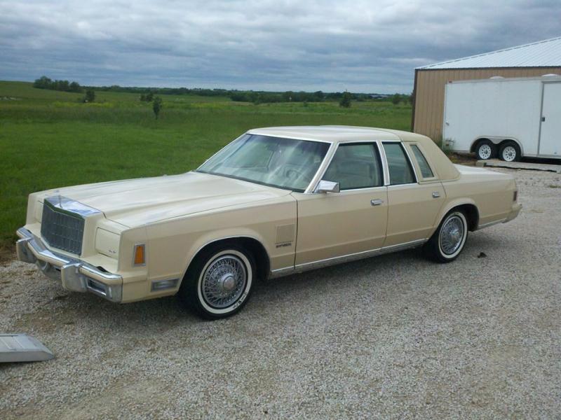

I have a '79 Chrysler New Yorker 5th Ave, 27,000 original miles. 360-2, used ProForm 66991 conversion kit.
After the install, first test fire backfired then wouldn't fire again after. We thought during the process it dumped too much fuel in and flooded it. Checked spark at coil and at spark plugs.
The spark seems to have a good amount of heat, and the dizzy is set exactly where the original one was.
We're kind of at a loss... and we're kind of "hobbyists" NOT mechanics!
Again, I did search, I read the threads, I am stuck. Help is what I'm looking for here, if your intentions are to tell me to do more research then please don't post as I am still continuously researching the problem.
Thank in advance! Here is a pic of her, Evelyn:
