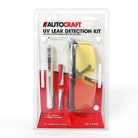

Buy a can of UV dye and one of these.. Works great and when you find the leak it will stick out like a sore pecker in a whore house.
got to use the uv dye to find it. Thats how I would do it.
