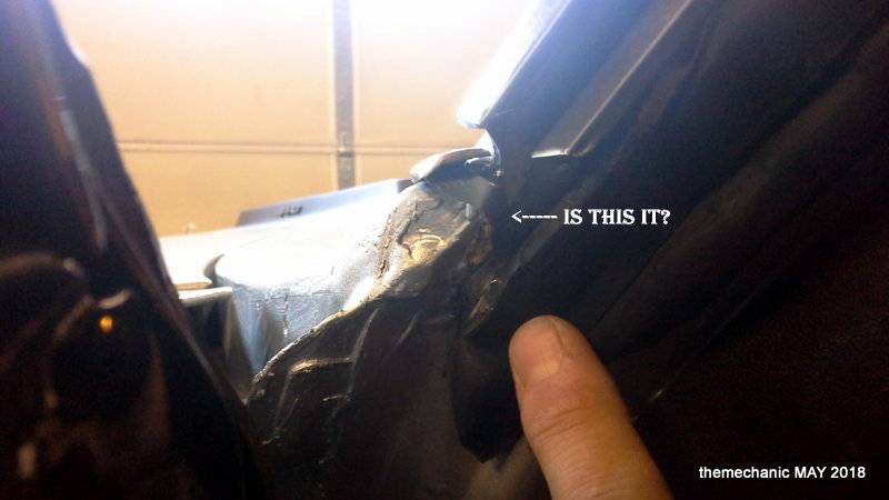

Here is a blurry picture, driver side....
They are there, maybe partially covered by w/strip.

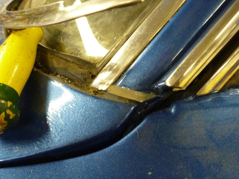

I didn't know mine were missing until I saw those for sale and started this thread. Are they really necessary?
They hold the far edge of window trim down. Definitely needed. Moparnation74 will chime in I’m sure.

Sure thing, Justin. Thanks for the link to the "ear pieces". I had no idea I was missing them even after I took the SS trim off the windshield.
