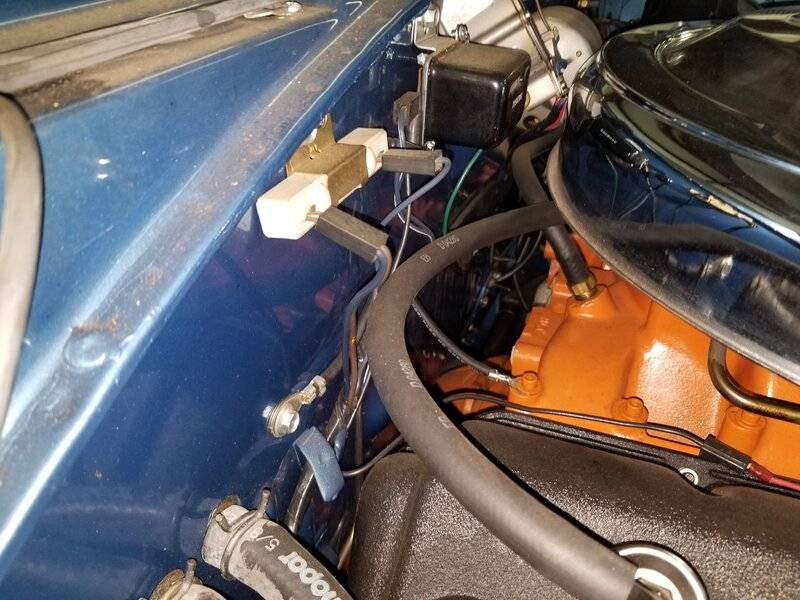

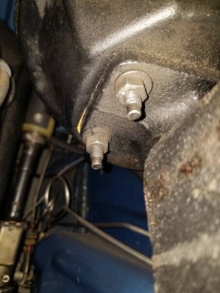

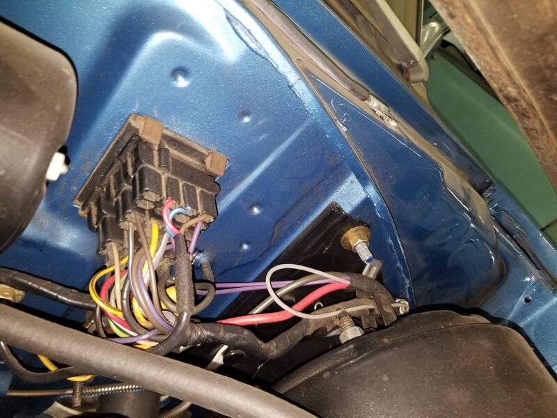

The starter relay and the horn relay for the 1967 coronet....... they are mounted on the firewall or fender?? I have no pictures to help me.
Mike
@Jerry Hall he I could have picture of 67 Hemi firewall wiring.
If you need more detail, I can get some pictures later.
Yes i need detail of the firewall with the appliances (Relays) showing its wire placement please. My hemi and transmission is a 4spd.
The placement behind the engine is hard to see.
Thanks Mike
Tomorrow is supposed to be a washout (rain) so that will give me time to take pictures and measure wheels. Anything else while I'm at it?
Thanks Mike
This help?
