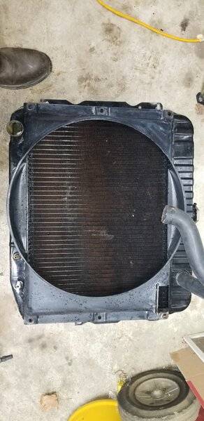

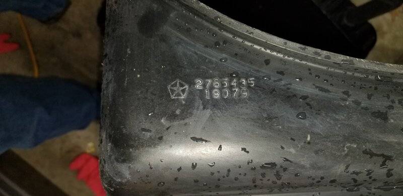

I have a 71 superbee that first had a 383 in it with air. But know it has a 440 but does not have air. Could not see any numbers on the radiator. Radiator does have cooling lines for trans.The shroud that i found in the trunk numbers was 2785435. 19079 . I'll take a pic when I get home from work. And post it. The mounting holes on the radiator dont line up with shroud. 20210518_043626.jpg
There is a very recent For Sale post by Rob Sharon: "1968 047 Radiator" that shows a good picture of what you should have embossed on the top of your radiator. (Not the same numbers, of course.)
How is the shroud mount on the radiator? Doe's it go over the mounting holes on the radiator??
View attachment 1111617 I have a 71 superbee that first had a 383 in it with air. But know it has a 440 but does not have air. Could not see any numbers on the radiator. Radiator does have cooling lines for trans.The shroud that i found in the trunk numbers was 2785435. 19079 . I'll take a pic when I get home from work. And post it. The mounting holes on the radiator dont line up with shroud. View attachment 1111618
The numbers should be very obvious, they are stamped into the top tank... What you have is likely a replacement radiator with no numbers....

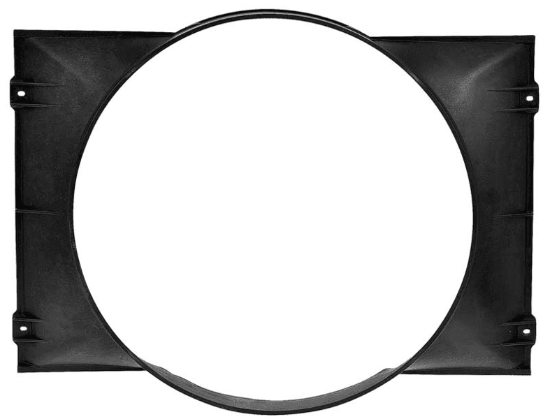

And your shroud is for a earlier B body (68-70) a 71 uses a shroud with only four attachment screws... like shown...

The radiator you posted a picture of is 26".. Not to mention a 71 B body with original A/C would have a 26" radiator...
