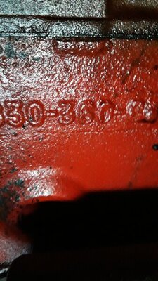

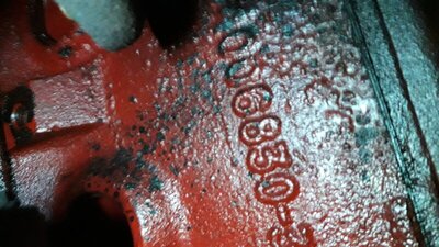

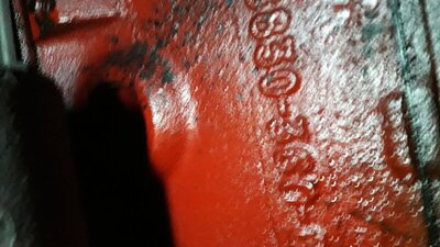

Thanks. It's hard to access that spot but so far I have made out the following
4006830-360-8? Not sure I am right about the first '4' and the last '8'. I can't make out the final digit. I'll have to get some of that paint off.
So at least it confirms it is a 360.

Thanks. The engine is reportedly from a 1978 Monaco. So the casting date fits in the timeframe.
I still plan trying to expose the number on the front of the block.

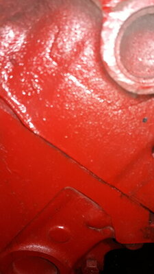

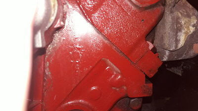

OK, back at this. I have the whole of my front subframe and suspension out and took time to remove the paint where I thought the engine number would be - front of top of block on driver (left) side. Am I looking in the wrong place because I see no numbers!
David

You’re in the right spot. I had a couple Lil Red Express trucks and that stamp is how you validated a ‘matching‘ engine. It tells a couple things like factory and 10k day number, tells what date it was assembled. I have no idea what engines got that stamping, seems they all should have. What are you trying to confirm?
I'd like to be able to confirm what car it came from. Supposedly it was originally in a 78 Monaco?
So, if I'm in the right spot, why can't I see anything? I'd assumed the number would be stamped in and visible after I stripped the paint but nothing.
David
From what I recall I don’t think there was info that would help determine what car it was in. IIRC it was plant, 360, 10k day date, sequence number. No VIN or anything like that.
Second question, no idea. If anything it started over just a little further towards the center of the engine, go inboard. The length of, it should be in the area you’re in. These were very faint stamps, don’t use anything abrasive to get rid of the paint.
You can just barely see it. Photo stole from the inter webs.
Look at the passenger side oil pan rail... Directly below the block drain, just to the rear of the motor mount bracket...
Agree. I thought they were just above the pan rail on the driver's side rear.
...unless it's a warranty block. Then there's just a blank machined pad.
...but should have other evidence, like a riveted tag under the driver's side front below the head, or the side of the block.
...unless someone worked pretty hard to take that off.
