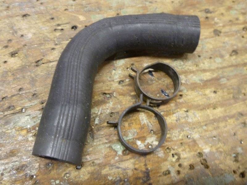

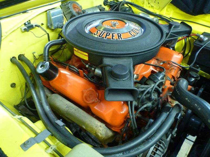

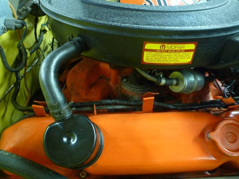

Well don't go by the hose in that picture, as I cheated with the 5/8" hose from snorkel to the BREATHER (not the PCV) by using a piece of old Mopar heater hose.
NOTE that picture you used is also a one year only 1971 air cleaner assembly, not a '70. A '70's breather hose comes off the passenger side of the round base and factory was formed and ribbed.

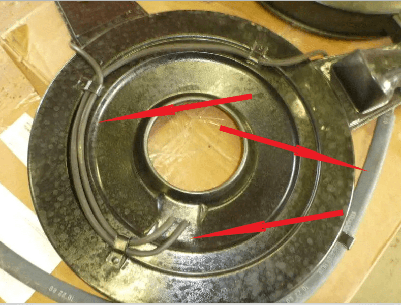

There are two vacuum diaphragm assemblies. The one that operates the flap of the hot air stove, gets connected to the thermal vacuum sensor and a "Tee" fitting, which opens and closes the flap valve controlling the hot air. The other end of the "Tee" fitting is connected to the manifold vscuum source. The other diaphragm assembly, on the non heated air inlet, is either open or closed. On cold start, both diaphragm assemblies close their respective flap valves. The flap valve on the heated air or stove connection operates in response to the air temperature inside the air cleaner. The other diaphragm assembly remains closed until the manifold vscuum drops at which time BOTH flap valves open allowing maximum unheated air flow. The thermal sensor operates only the hot air diaphragm assembly. Your pix shows them incorrectly assembled. The FSM shows the correct way..... any 3/16" vacuum tubing will work...unless you are building a 100 point car.....99.5% of the average viewing people will not know the dufference if you use ribbed on nonribbed hose......just a thought.....
