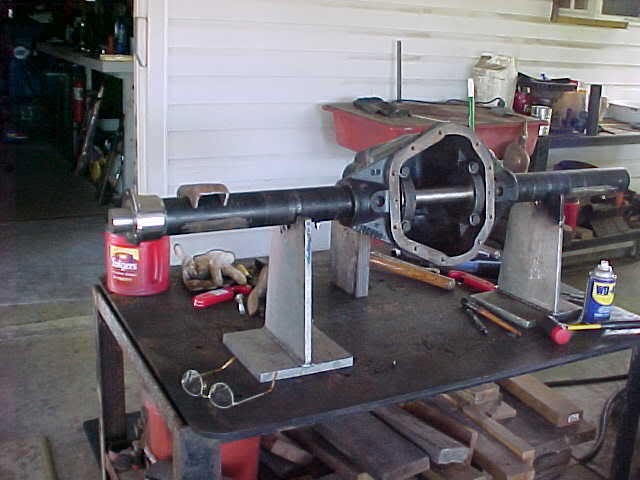

Since you're already planning for another one, it probably won't cost anything to try to fix it. I know guys who already plan on straightening before the rear end is even used, because of warpage from welding on different mounts. Take a look at these:
http://www.forabodiesonly.com/mopar/showthread.php?t=254174
http://jeepin.com/forum/showthread.php?t=63703
http://www.garagejournal.com/forum/showthread.php?t=46369
Thanks. I wasn't too sure about straightening the housing until I read those forum posts. The alignment shop this morning recommended a guy nearby that straightens housings. I'll give him a call tomorrow and see what he charges.
