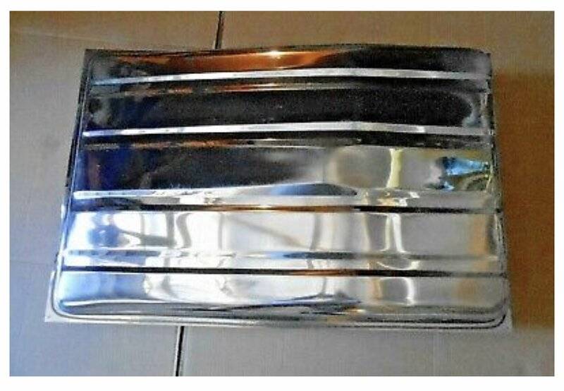

Have you thought about a stainless steel tank? https://www.ebay.com/itm/403286197964?fits=Year:1969|Model:GTX&hash=item5de5bb06cc:g:0yUAAOSw4x5dXBYW

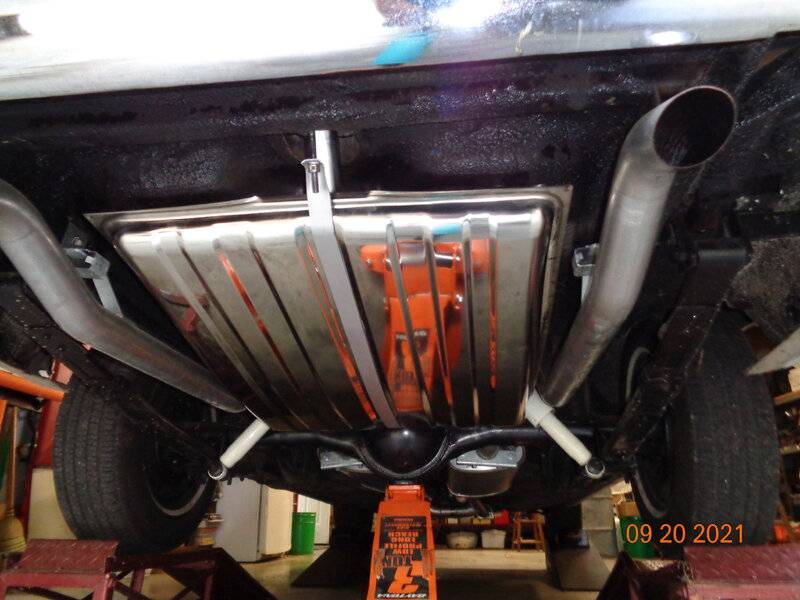

I went with stainless on my 64 Plymouth. I have not decided yet if I am going to leave it unfinished or paint it black.
Keep in mind that today's crappy gas with ethanol turns to water and causes rust issues much more than the real gas used when our cars were new. And it's going to keep getting harder and more expensive to get the non ethanol gas. Especially in the current political climate! View attachment 1243426

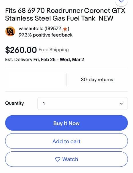

I’m thinking there’s two places that sells stainless steel tanks, Vans is who I bought mine from. Great to deal with. Just make sure if you need a California emissions tank to let them know.
