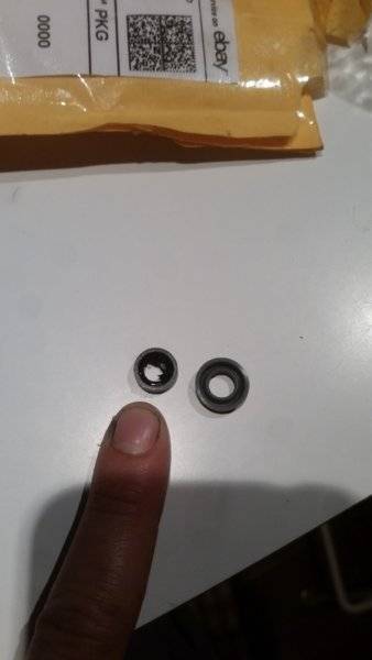

I need a seal for the speedometer pinion. I bought one on but it turned out to be wrong. its about an 1/8" too large in diameter, I have my old one which is damaged to compare it too, but also it just doesn't fit. I know someone must have been down this road... thanks in advance.
Here's a pic, I'm pointing to the correct one that I need. Next to it on the right is the one from ebay which is too big. I bought it in a kit with a red o ring and metal clip. I guess its only for 1966 and later 727 trans

What is the OD & ID of the seal you need?
on the damaged original seal the OD is 7/16" and the ID is just a hair under 1/4" - that's what I need
the one I bought is 1/2" OD, and even though that is close, it wont fit into the hole without folding up on itself

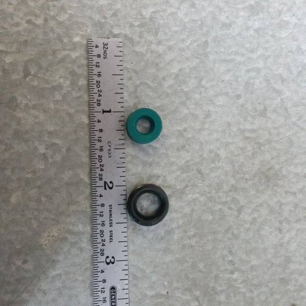

I believe this is it. New style on the right. PM me your address and I'll send it to you.
