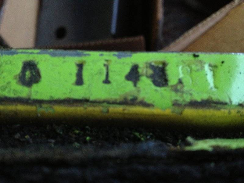

For a visual reference, here is my trunk gutter on my 70 Road Runner prior to restoration. The number will be a partial of your VIN
A little strange that it looks closer to an I than a 1 as it's a 1 on the fender tag and dash tag
