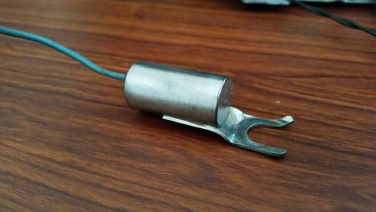

The wire broke off the one on my car and my spare isn't much better, goes from negative on coil to ground, would like to get a new one. Part number 3501598, and search didn't yield anything.

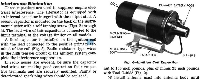

This is from the service manual...
Thanks for posting my manual doesn't show this or in the wiring diagram either. I see this says to the positive terminal, but mine has always been to the negative terminal, and the car doesn't run with out that connect to ground and if the service manual was to be believed it shouldn't be there, but I cant see where the circuit is getting its ground, strange!

Thanks for posting, however, for $30 bucks for used, I can fix one of mine, besides the title on that ad says "Cleaned" and looking at the plug where the wire goes in, its been fiddled with! If it was NOS, yeah, maybe I would pay that.
Sorry, that was from the 1969 Coronet/Charger/Dart manual. I always default to that one, so the info is likely different for your particular application.
No worries man, appreciate that post, and its got me thinking, why my car doesn't run with it. If its primary function is suppress radio noise, then it should run with out it. Plus, mine is hooked to the negative of the coil, which means its just acting as a ground, and if that is the case, then I am wondering if my electronic control box is and has been bad all these years. The black wire with yellow stripe that goes from negative terminal to ECU, shouldn't that provide the ground?
