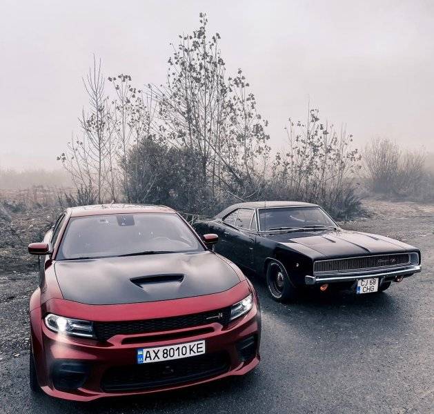

I attached a pic to show how much lower my car sits from stock, to ask you if it is too much (front tire is 245/60). I met this gentleman from Ukraine who escaped with his family when the war broke out (Transylvania is South of the border from Ukraine). He has a '20 392 Scat Pack, and we saw each other totally by chance, here both of our cars are pretty rare. Hence we met again at Halloween (here we call it Illumination) to make a short photo shoot, old Charger vs last Charger...
