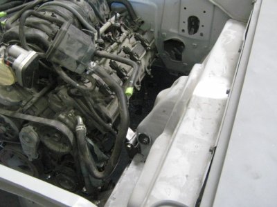

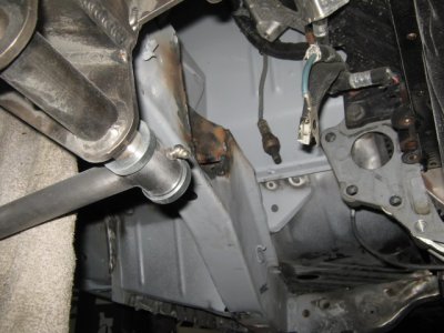

I no longer have a stock suspension, installed an AlterKtion, but I have a 5.7 in my 70 GTX, which is the same engime compartment anyway. I ended up using the stock manifolds. I called TTI and their engineer told me straight uo that he could NOT make a set of headers for my car because he could not get a clean enough bend around the starter motor. My engine came from a car, not a truck. As is is, I cut a circular "notch" out of the frame rail and welded a piece of thick walled 3" dia pipe in place so the flange at the collector (manifold to exhaust pipe) would clear.
Since I now have a power assisted rack and pinion I cannot comment on that side, mine has plenty of room there now.
