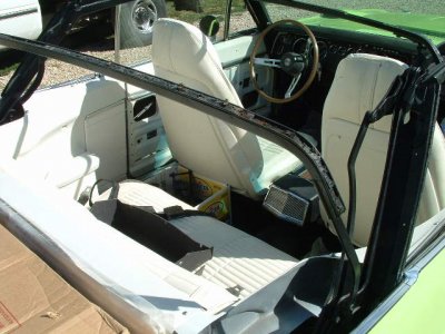

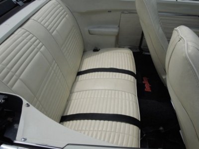

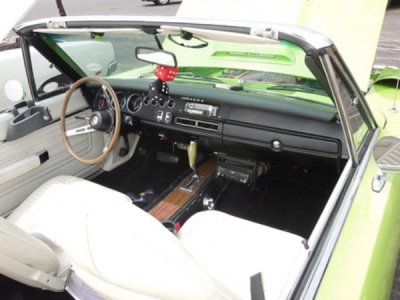

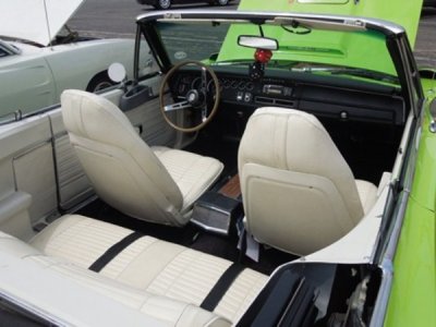

even the later 75 up b bodies had a similar style bucket high back bucket seat , seat tracks are going to be 70 and older only if you want direct bolt in .
I put 72 charger seats in my convertible , recovered them in 70 challenger tuck and roll style upholstery and used 71 new yorker power seat tracks to have 6 way power seats .
Going by what you first said, you had to make modifications to the 71 New Yorker tracks to fit them in?
I like the 70 Challanger upholstery! How 'late' of a seat frame will that trim fit? Obviously 72 charger, but any later?
Thanks for the info!
at least 74 but like i said the 75 ups look the same to me also but i'm not sure
the newyorker seat tracks bolted right into the correct placeds on the floor it was mating the seat to the frame but it wasnt to bad frome memory anyway
