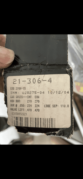

You [ & some others ] are paying too much attention to advertised duration #s. The duration measuring points vary, generally from 0.004" to 0.008". Usually tappet lift, but not always..... The Comp is 270* is measured @ 0.006" of tappet lift. Some cams are measured at valve lift. So if you are comparing cams to say the Comp 270, a cam with 270 @ 0.006" valve lift is going to have less adv duration than the Comp because that equates to 0.004" tappet lift [ 1.5 rockers ].
Some of the cams listed above do not list this important info, so useless trying to compare cams that way.

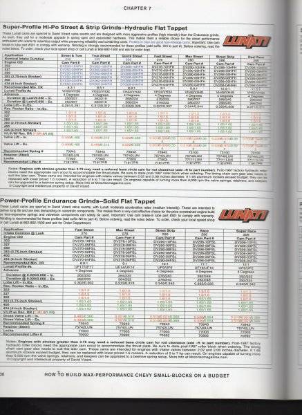

Basically it has engine sizes from 302 to 434 ci. It then has performance categories, from Street & Tow to Real Race.
Post #27 is just one section in DVs SBC book. There are other sections for roller cams etc.
However, each category is the same in these respects: Take Real Race. All engine sizes have the same duration. What changes with each size is LSA. It gets tighter with more cu in. That is because the bigger the engine, the more air it needs, so more overlap [ tighter LSA ]. 434 ci uses 104 LSA for all performance categories. For Street & Tow, the duration is much less but LSA is still 104.

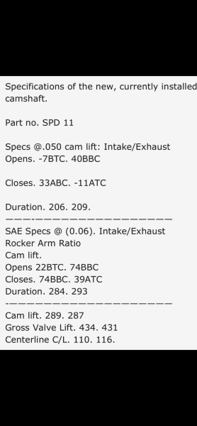

This build was based on keeping it as close to stock as possible. I was concerned about the Melling cam because of the advertised duration of 284 and 293 at .006. I was thinking that would create a rough idle.

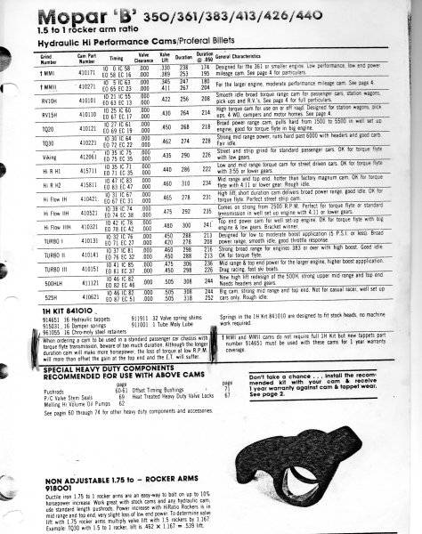

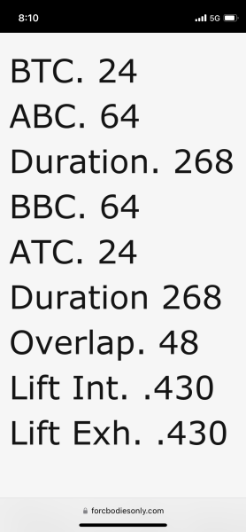

The original cam had these numbers and is not being used.

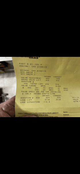

Next up is the cam from Melling and is now in the short block
I wonder how the above cam will act in this heavy car. It will not be a high rpm use engine and looking for a lower Torque & Hp range.

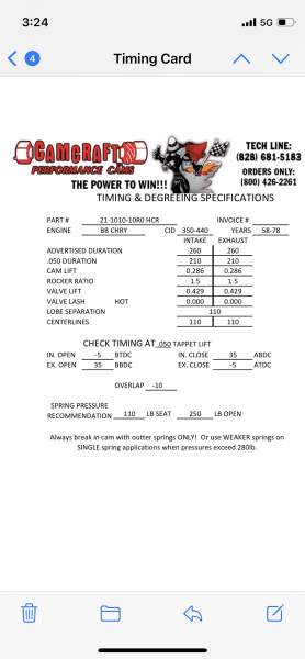

Now two more camshafts are listed below. The first one is the recommended replacement cam from the Chrysler 300 International Club and is made by CamCrafters. The second is a Comp Cams RV cam that is new but 30 years, or more, old.
COMP CAM specs are shown below in 2 pictures, the cam box and the card inside with the cam.
