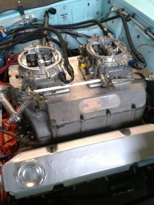

With proper carb tuning the edelbrock or carter will outperform any holley imo. I just switched back from holley 770's to my edelbrock 800's and picked up ,25
So I disagree with a lot of whats said about edelbrocks.,
I have them on most my cars and I don't do too bad.

Pretty impressive set up! that looks sick.
