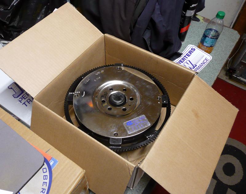

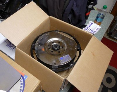

Call Eric at: JW Performance 321-632-6205
I put a 10" 3400 stall in my car based on their data form. Converter works great and I am very happy with it, reasonable prices too.
