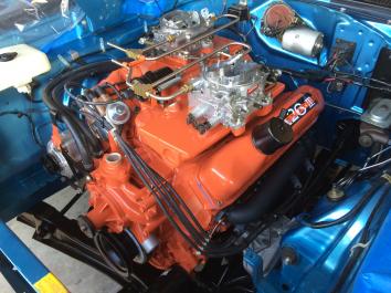

Mine has a 440 source. The corner boss of the front upper bolt hole is ground for the retaining clip for the cap.
Doug

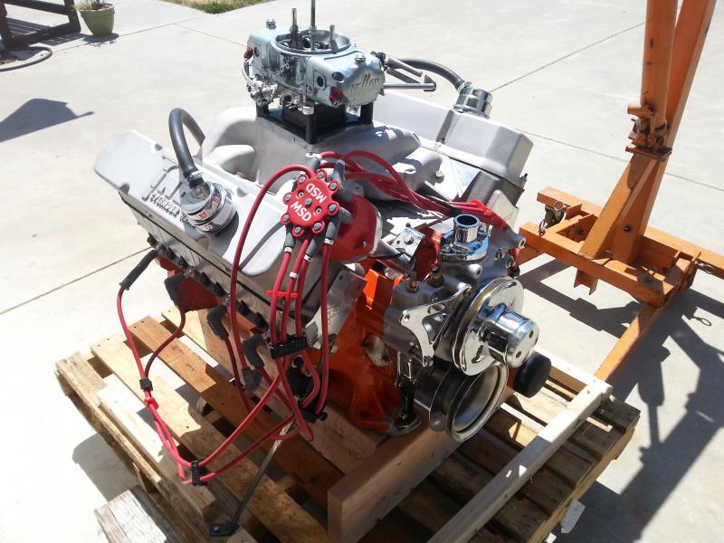

MSD #8546 fits with INDY Heads
crate 1.jpgI have INDY Heads. The correct distributor to clear everthing is the MSD #8546 which is the exact one that I have and it fits fine, even with the tall (and thick) INDY valve covers.
A $75 source distributor (with vacuum advance) and 5 minutes with a die grinder. Or Fire core $165, or $290 MSD distributor, umm? Guess I'm cheap.
Doug

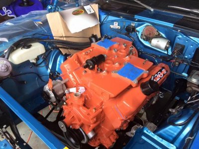

This 493 engine was meant for a 64 Plymouth, but found a home in the Road Runner. Should look quite interesting anyways.

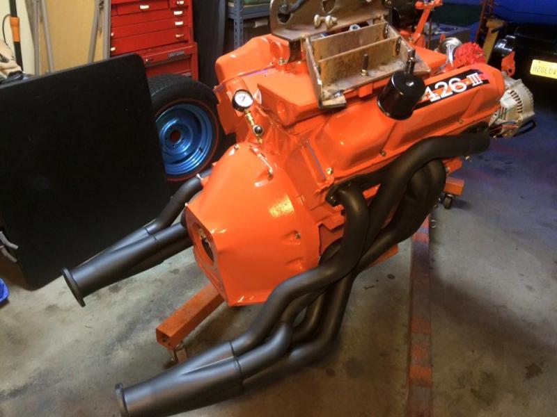

I may be in deep sh... with my new build as far as the distributor. I have a old iron Hemi tach drive magnetic that works great. I really hope it fits with Indy heads, not confident.
