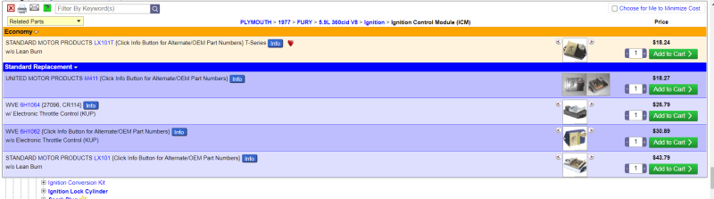

Another factory style option would be just get a module from RockAuto, maybe buy the more expensive one to run and a cheap one for a backup.
I put in a 77 Fury 360 (my first car)
