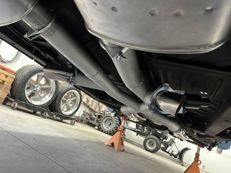

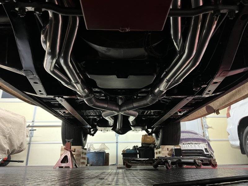

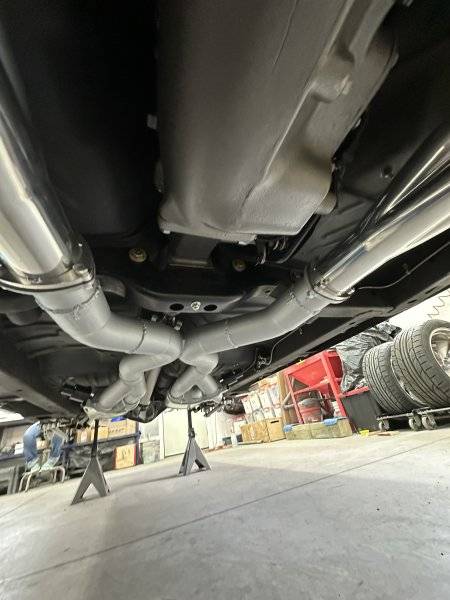

Full 3" TTI from headers to tips with QTP cut outs. Nice and snug. Even around the fuel tank. No issues.
Well worth the $$.
Well worth the $$.

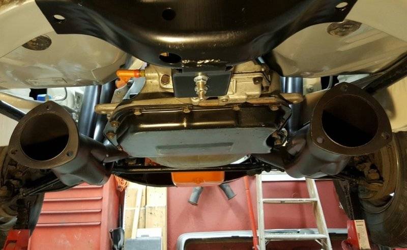

That system is very similar to the 493mike system on my 65! Your collectors line up with the crossmember better than mine do but my engine is back as far as I could get it placed.
Mike
