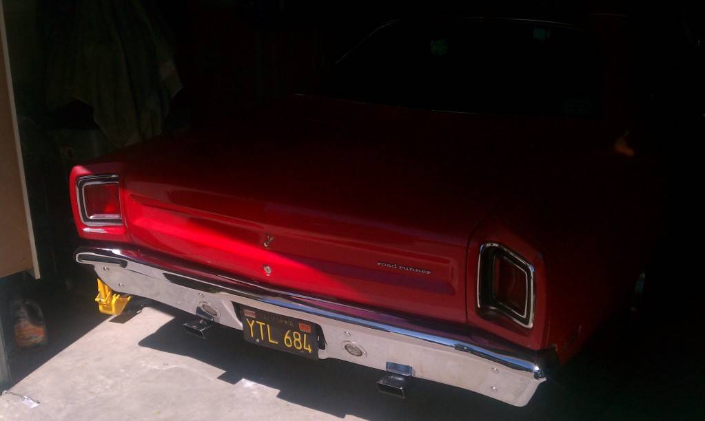

My 69, same all around rear, both sides

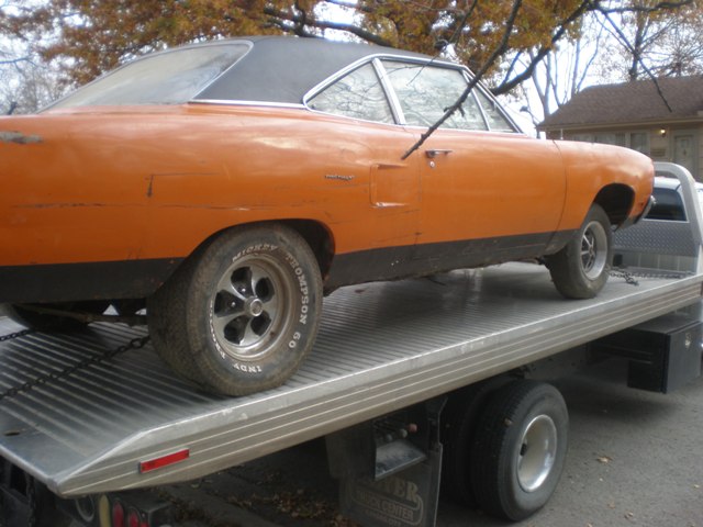

but 69 and 70 those same metal emblems mounted on the door in 69 and on the quarter panel in 70 . Same exact ones also i believe the volare RR's used them but they didnt have the pins they were just an adhesive stick on emblem but the same size and font .

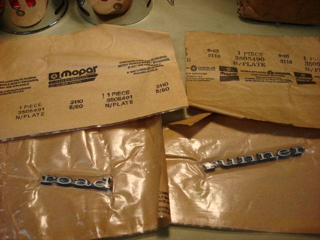

The pined version of those pot metal badges were used primarily, from 69-72, on the body sides at various locations from year to year. 69’ doors, 70’ aft of side scoops, 71’ quarter panel-above rear wheel wells, & 72’ forward of rear wheel openings, just aft of door, 1 ¾” up from detail line. The 69'RR, 70’ RR, & RR super birds without the rear tape stripe used them on the trunks lids. A stick-on version of those badges was used from 73' and up, again at various locations in the later years with some of them on 73-74’ RR deck lids with a standing bird decal.
I do recall the pinned versions being superseded by the stick-on versions at some point later on, and having to use stick-on badges over holes on earlier cars.

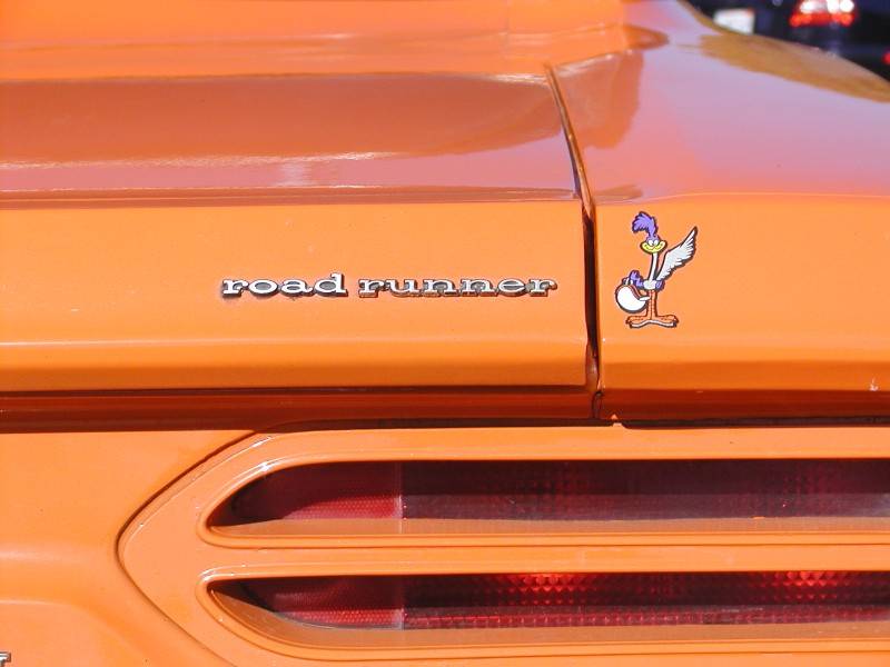

73-74' Deck Lid;
I thought they did, but I only see the standing bird these days. But wasn't the 73-74 the ones that used the adhesive on the back?
