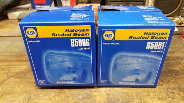

i want to buy all new.autozone and sylvania list the same numbers for my car
H6024 for low
H5001 for high
one seems to be a larger diameter than the other.
i think both of mine are the same size.
also the ones in the car have 3 prongs but only one uses a 3 prong plug.
the other has 2 but it plugs in missing the center prong completely.
All of your headlights would be the same smaller diameter. The outside headlights have HIGH/LOW beam feature, and have 3 prongs. The inner headlights are HIGH beam only, and have 2 prongs. I do not know current part numbers.
thanks maybe they were wrong when i got it because all of my bulbs have 3 prongs .
Napa had the H5006 and H5001 bulbs. Wagner product, made by Federal Mogul. The problem I had with the Phillips was that the high beam (H5001) had the wrong backs on them. The three nubbs were orientated like the low beam (H5006).
I like the Sylvania Xtravision - 5001 are brights and 5006 are low beam lights.
those are the ones im getting ive used the silverstars before but they randomly blew out in less than a yr.
they were bright though.
thanks ive got all of the correct ones now.
