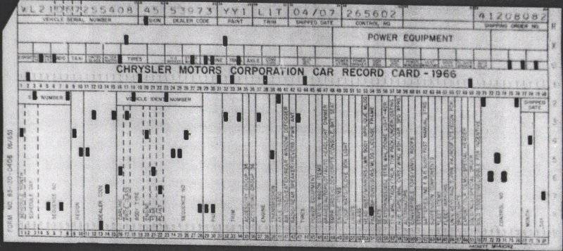

Received build card for my 1966 for FCA/Stellantis.
Plant VIN code 7 does not match Plant code 1 on radiator support
Production Date 412 does not match stamped numbers 525 on radiator support
Shipping order 08082 does not match stamped numbers 09046 on radiator support.
Should stamping on the body match numbers on the IBM build card?

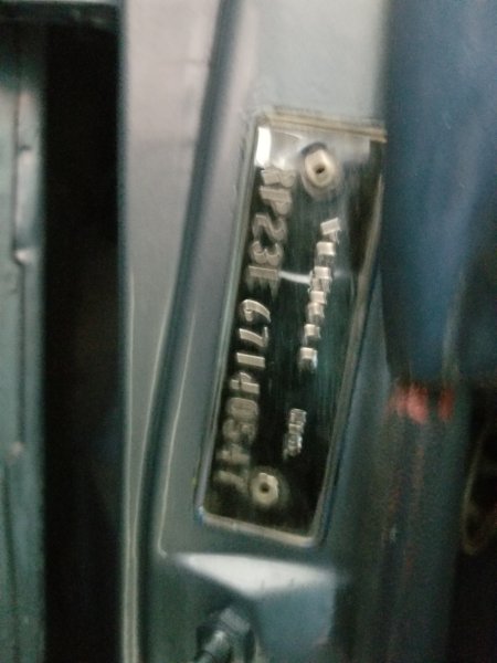

Fender Tag Missing

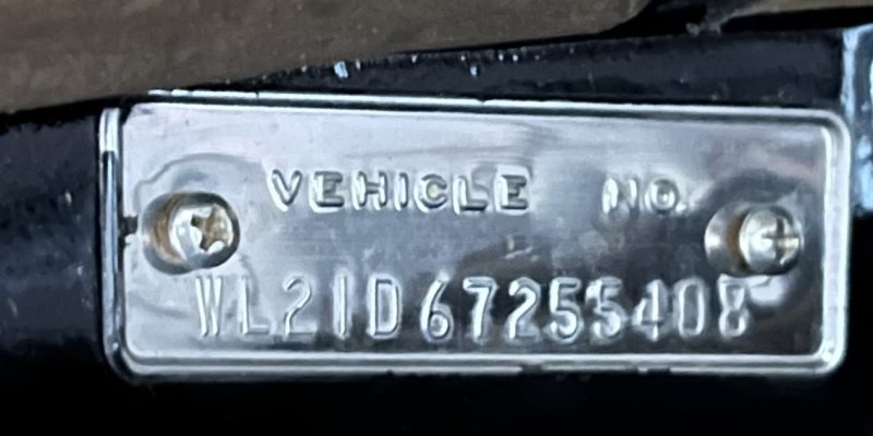

VIN attached with sheet metal screws, not rivets

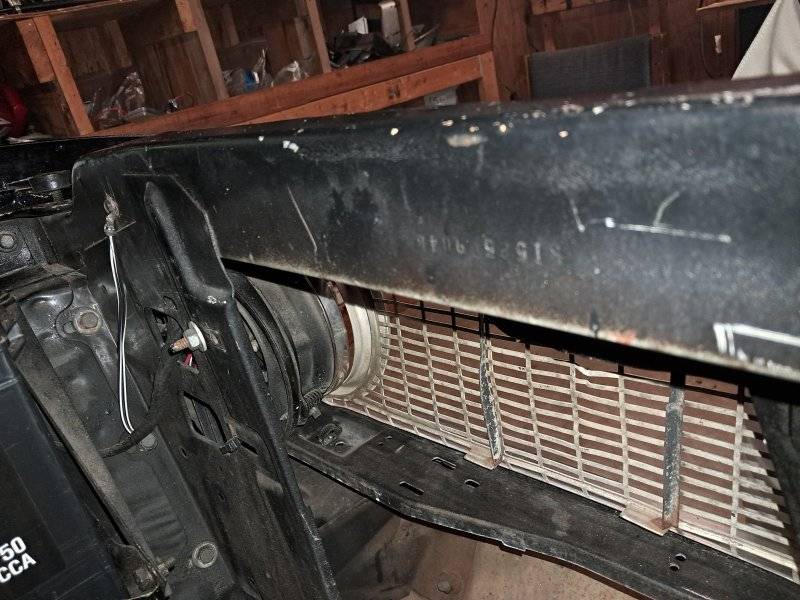

For 1966 Coronet, VIN is not stamped on car body except for the plant code. Year 6 (1966), Plant 1 (Lynch Road), Production Date 525 (May 25), Shipping Order # 09046 is stamped on radiator core support, See picture below.
And Same Numbers should be stamped on body x-member behind left side of rear bumper

Incorrect screws on the Vin tag, they should be rosette rivets. Yes possible Vin swap from another car. Do you have the fender tag and the build sheet? Does your car match everything else on the IBM card?
If you haven't registered the car those sheet metal screws if they look at them could be a problem. Get the proper rivets.
Tho SO number on the rad support should match the SO number on the IBM card. Check the rear body code to see if it matches the front. If it does then the IBM card and the VIN tag do not belong to your car

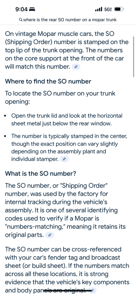

Where do I find the rear body code?

Incorrect screws on the Vin tag, they should be rosette rivets. Yes possible Vin swap from another car. Do you have the fender tag and the build sheet? Does your car match everything else on the IBM card? View attachment 1914333
In original post, I said Fender tag missing. I also said body stamp does not match IBM card for order number. There is no build sheet in seats or dash. Seats are recovered. Car is repainted black, should be saddle bronze. Interior is tan, which matches IBM card.
I titled and registered the car. Trying to compare body stamp to IBM card to see if I registered a VIN swap car. By card, scheduled production date is 4/12, by stamp 6/15. Order numbers are different too.
The rear body code is on the rear crossmember, usually between the two bumper brackets. If it is rusty in that area you might not be able to see it. If you can't find it, then the rad support is all you have. If it looks factory original then I would have to say, VIN swap.
My 67 Satellite that I'm currently restoring, the SO# is on the core support and the rear cross member just to the left of the left rear bumper bracket. They should match the order # on the IBM card.

SO number on card is- 4120802
Stamp on core support is awfully long ending in- 2509046
I understand on a 66 they may even be on the rear cross member under the rear bumper reinforcement mounts.

The rear number on mine is under the pass side rear bumper bracket. Cant be seen unless R+R the bracket
The ft one is drivers side of the radiator support , facing the radiator itself and hard to read
Nothing on the body matches a Vin tag on 67 and down
You need either the build sheet or the IBM card to tie the two together

And like said . Only the IBM card or build sheet tie the vin to a particular body. Without them no one would ever know
