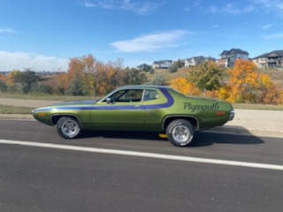

I have a soft spot for 71-72 plymouth b bodies. Hoping to get our 72 satellite running soon.
