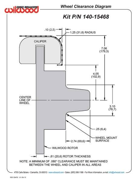

I want to install the Wilwood 12" brake package on my Charger (part# 140-15648D).
I'm currently running 15" Cragar D window wheels and the, according to Wilwoods data sheet, they won't fit inside the wheel.
I'd like to run 15" steel rims of some sort but I can't seem to find any that will clear the calipers.
They need 7.06" from the center of the rotor hat to the inside of the wheel.

You need, according to the schematic, 4 inches from the caliper to the face of the rim (where the rim sits against the hub). You should measure what you have now, if you got the 4 inches, it’s doable. If not, a small spacer could work to get that distance. Remember, the 15’s were used with the Mopar 11.75 rotor combination and those are pretty bulky.
The measurement that is causing be issue is the distance between the hoop of the wheel and the caliper.
As per the diagram it needs 7.06 inches from the center of the wheel measured from the face of the rotor.

Ok, so I bit the bullet and bought the 11" kit and now I'm kicking myself.
I could have easily fit the 12" kit. The measurements that Wilwood provides aren't very accurate.
I have easily 3/4" clearance between the caliper and the wheel.
I'm seriously considering calling Summit and seeing if I can swap kits
The hub bore on the Wilwood brakes are 3.1, or 83.82. Something else that will cause wheel fitment issues.
