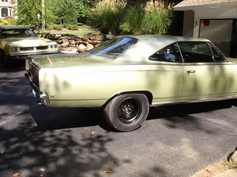

yo bigman...my 70 runner has 255-60 15's on it....look in my gallery for the pix. my mag 500's are 4.25 back space

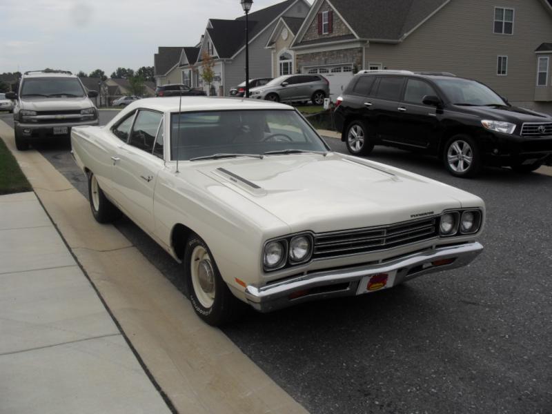

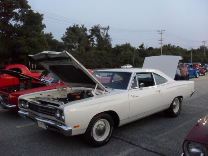

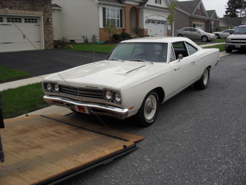

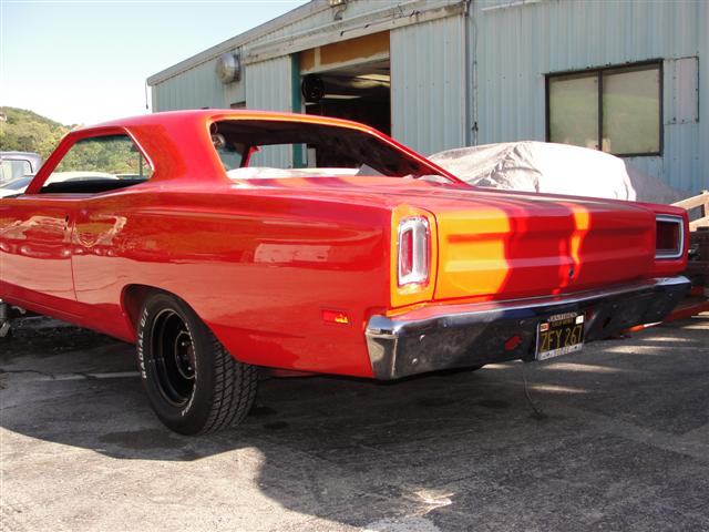

I have 275/60/15 on my 69RR,Craig one of the FBBO members who I bought the car from did a tremendous job making it have an awsome stance.have some pictures here but can give you more info if wanted on the backspacing the car has airshocks with very minimal air in them. SAM_1631.jpgSAM_1615.jpgView attachment SAM_1610.jpgSAM_1609.jpgView attachment SAM_1610.jpg

I have 275/60/15 on my 69RR,Craig one of the FBBO members who I bought the car from did a tremendous job making it have an awsome stance.have some pictures here but can give you more info if wanted on the backspacing the car has airshocks with very minimal air in them.View attachment 89234View attachment 89235View attachment 89236View attachment 89237View attachment 89236
Love the look of the wheel and tire widths and stance!
Can you please tell us what the front tire size is?
Also can you please tell us what wheel widths you are running on front and back?
Would like to also see a side view shot of your car if you have it. Thanks.
Yea Santas' still here.Tires in front are 215/70/15 and rim width are 15x6 in front and 15x8 in rear.
